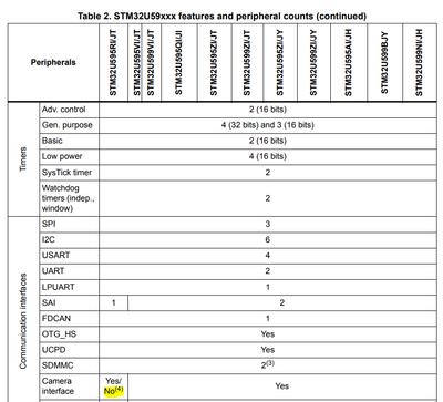

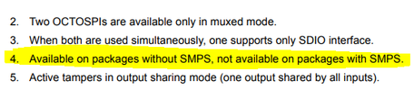

The DCMI interface is not supported in the STM32U595RJT6Q, but is supported in the STM32U595RJT6 as mentioned in the datasheet.

AN5020 application note mentioned some CMOS sensors examples that are compatible with the STM32 DCMI.
