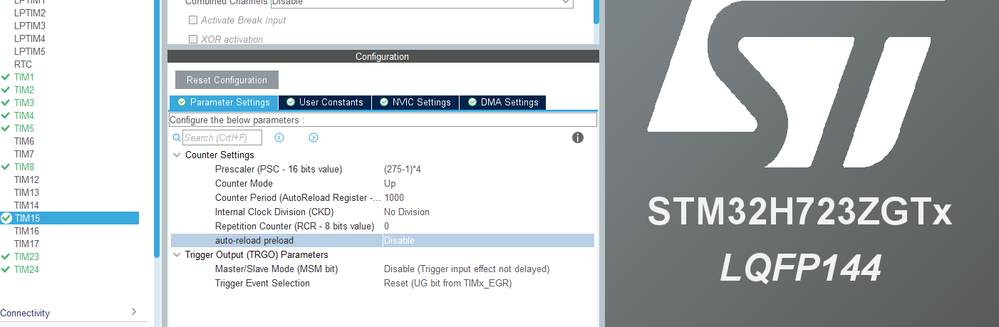

Hi everyone,
I'm using Nucleo H723 board. I have used 8 timers in encoder mode to read the encoders. I have also activated another timer to make an interrupt every 4ms to send the data via Usart.
everything work good but when I use sprint code to put the data in Usart, the interrupt time has been changed and it's not 4ms.
Part of my code inside interrupt:

}Hier is my timer configuration.
when I delete the sprint codes the timer 4ms runs again correctly.
I appreciate it if you help me.

2022-02-24 2:08 PM
You'd do better queuing the data you want to send, and using functions that don't block execution, but rather manage that in the UART interrupt, and don't generate data faster than the serial port can output.
At 9600 baud every character takes around 1 ms
HAL_UART_Transmit() blocks, it has no place in an interrupt.
2022-02-24 2:39 PM
Thanks for your reply.
But there is a lot of data (15000 numbers) I think queuing is not possible.
And when I use the HAL_UART_Transmit in the While loop it does the send data not every 4ms.
It's very important to record the data every 4ms. Doing the record I have no problem. I have only problem sending the data to PC to save them. (logging)
Do have any idea how I can do it?
2022-02-25 12:03 AM
As @Community member already said, one should urgently leave time-consuming activities out of an interrupt routine, especially such blocking calls. In your case, this is exacerbated by the fact that you convert the values into decimal numbers, which contain a lot of "hot air", i.e. redundancy.
If you have to send data permanently and cannot store it temporarily in a FIFO or ring buffer, then please do so at maximum speed and in binary in order to achieve maximum data throughput.
Regards
/Peter
