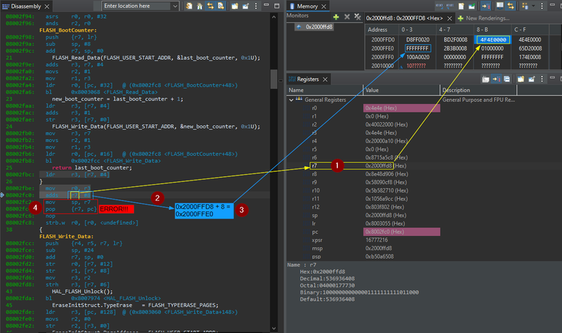

‎2024-06-19 8:48 AM - edited ‎2024-06-19 8:59 AM
Hi @waclawek.jan,
yes, I understood your point. By following your instructions, I was able to locate the offending code.
The issue is created in the following function that first reads and then updates the flash:
uint32_t FLASH_BootCounter(void)
/* Read the current boot counter */
uint32_t last_boot_counter, new_boot_counter;
FLASH_Read_Data(FLASH_USER_START_ADDR, &last_boot_counter, 0x1U);
/* Increment the boot counter */
new_boot_counter = last_boot_counter + 1;
FLASH_Write_Data(FLASH_USER_START_ADDR, &new_boot_counter, 0x1U);
return last_boot_counter;
The disassembly code related to the last function is:
24 FLASH_Write_Data(FLASH_USER_START_ADDR, &new_boot_counter, 0x1U);
08002fb0: mov r3, r7
08002fb2: movs r2, #1
08002fb4: mov r1, r3
08002fb6: ldr r0, [pc, #16] @ (0x8002fc8 <FLASH_BootCounter+48>)
08002fb8: bl 0x8002fcc <FLASH_Write_Data>
25 return last_boot_counter;
08002fbc: ldr r3, [r7, #4]
26 }
08002fbe: mov r0, r3
08002fc0: adds r7, #8
08002fc2: mov sp, r7
08002fc4: pop {r7, pc}
08002fc6: nop
08002fc8: strb.w r0, [r0, <undefined>]
When the pc points to the 08002fc0 address the memory contains:
0x2000FFD8: 4F4E0000
0x2000FFE0: FFFFFFFF
When the adds operation is executed, r7 changes from pointing to the memory address 0x2000FFD8 to the new address 0x2000FFE0 which now contains an invalid memory value: 0xFFFFFFFF.
I stepped through then the entire FLASH_BootCounter function and I found out that the issue it is in the FLASH_Read_Data function.
I then stepped through the FLASH_Read_Data function disassembly (it took me all day!) and here are the results:

08002f98: push {r7, lr} --> r7 = 0x2000FFF0 (contains 0x20000A10), lr contains the returning address
08002f9a: sub sp, #8 --> sp = 0x2000FFE0 (contains 0x2000FF0)
08002f9c: add r7, sp, #0 --> r7 = 0x2000FFF0 sp = 0x2000FFD8 (contains 0x8003B27)
21 FLASH_Read_Data(FLASH_USER_START_ADDR, &last_boot_counter, 0x1U);
08002f9e: adds r3, r7, #4 --> r7 = 0x2000FFD8 + 4 = 0x2000FFDC (contains 0x800D2C4)
08002fa0: movs r2, #1
08002fa2: mov r1, r3 --> r3 = 0x2000FFDC (contains 0x0800D2C4)
08002fa4: ldr r0, [pc, #32] @ (0x8002fc8 <FLASH_BootCounter+48>)
08002fa6: bl 0x8003068 <FLASH_Read_Data>
-----------------------------------------------------------> jumps to code below
FLASH_Read_Data:
08003068: push {r7} --> r7 = 0x2000FFD8 (contains 0x8003B27)
0800306a: sub sp, #20 --> sp = 0x2000FFD4
0800306c: add r7, sp, #0 --> r7 = 0x2000FFC0 (contains 0x800D2C0)
0800306e: str r0, [r7, #12] --> r0 = 0x803F800, r7 = 0x2000FFC0 + 12 = 0x2000FFCC (contains 0x803F800)
08003070: str r1, [r7, #8] --> r1 = 0x2000FFDC, r7 = 0x2000FFC0 + 8 = 0x2000FFC8 (contains 0x2000FFE0)
08003072: mov r3, r2 --> r2 = r3 = 0x1
08003074: strh r3, [r7, #6] --> r7 = 0x2000FFC0 + 6 half word (contains 0x0)
At this point:

79 *data = *(__IO uint32_t *)StartPageAddress;
08003076: ldr r3, [r7, #12] --> r3 = 0x1, r7 = 0x2000FFC0 + 12 = 0x2000FFCC (contains 0x803F804)
08003078: ldr r2, [r3, #0] --> r3 = 0x803F804, r2 = 0x0 <<<<<<<<<< The address pointed by r3 is empty (non flash data there), then r2 is loaded with 0xFFFFFFFF
0800307a: ldr r3, [r7, #8] --> r3 = 0x803F804, r7 = 0x2000FFC0 + 8 = 0x2000FFC8 (contains 0x2000FFE0)
0800307c: str r2, [r3, #0] --> now r3 = 0x2000FFE0 and r2 = 0xFFFFFFFF, when this instruction is executed the 0xFFFFFFFF is loaded into the 0x2000FFE0 address

08003098: nop --> r1 = 0x2000FFDC, r2 = 0xFFFFFFFF, r3 = 0x0, r7 = 0x2000FFC0
0800309a: adds r7, #20 --> r7 = 0x2000FFC0 + 20 = 0x2000FFD4 (contains 0x2000FFD8)
0800309c: mov sp, r7 --> sp = 0x2000FFC0
0800309e: pop {r7} --> sp = 0x2000FFD4, r7 = 0x2000FFD4 (contains 0x2000FFD8)
080030a0: bx lr --> sp = 0x2000FFD8, r7 = 0x2000FFD8 (contains 0x08003B27)
returns from the code above <----------------------------------------------------
23 new_boot_counter = last_boot_counter + 1;
08002faa: ldr r3, [r7, #4] --> r3 = 0x0, r7 = 0x2000FFD8 + 4 = 0x2000FFDC (contains 0x00005F34)
08002fac: adds r3, #1 --> r3 = 0x5F34
08002fae: str r3, [r7, #0] --> r3 = 0x5F35, r7 = 0x2000FFD8 (it contains 0x08003B27, it will contain 0x00005F35)
08002fb0: mov r3, r7 --> r3 = 0x5F35, r7 = 0x2000FFD8 (contains 0x00005F35)
08002fb2: movs r2, #1 --> r2 = 0xFFFFFFFF
08002fb4: mov r1, r3 --> r1 = r3 = 0x2000FFD8 (contains 0x00005F35)
08002fb6: ldr r0, [pc, #16] @ (0x8002fc8 <FLASH_BootCounter+48>) --> pc = 0x8002FB6 + 16 = 0x8002FC6
08002fb8: bl 0x8002fcc <FLASH_Write_Data> --> This function not inserted here <--

26 }
08002fbe: mov r0, r3 --> r0 = 0x0, r3 = 0x5F34
08002fc0: adds r7, #8 --> r7 = 0x2000FFD8 (contains 0x00005F35)
08002fc2: mov sp, r7 --> sp = 0x2000FFD8, r7 = 0x2000FFE0 (contains 0xFFFFFFFF) <<<<<<<<<< here the wrong memory address is pushed into the stack
08002fc4: pop {r7, pc} --> r7 = sp = 0x2000FFE0 (contains 0xFFFFFFFF)
--> sp = 0x2000FFE8, r7 = 0xFFFFFFFF
08002fc6: nop

‎2024-06-19 9:30 AM
>>Why did you point to that particular instruction?
Because it's the WRITE that's causing the IMPRECISE fault
r7 == 0xFFFFFFFF is problematic, suggesting it got trashed somewhere along the way, assuming the compiler didn't generate bad code. It's probably a pointer to one of your structures, perhaps locally on the stack.
Code/Execution level failures can occur if the FLASH Wait States are too aggressive, especially in the prefetching paths.
Perhaps it's a code inlining optimization issue? Is the boolean value used anywhere? It looks like it staged unnecessarily (where r7=sp, local on the stack frame), and then passed to the function.
‎2024-06-20 6:23 AM - edited ‎2024-06-20 6:23 AM
it's simpler than that. Look at the end of loop condition of this function:
void FLASH_Read_Data (uint32_t StartPageAddress, uint32_t *data, uint16_t n_words) { while (1) { *data = *(__IO uint32_t *)StartPageAddress; StartPageAddress += MEMORY_OFFSET; data++; if (!(n_words--)) break; } }
It reads from FLASH and writes to destination (which is given by pointer) one more word than is n_words, so
uint32_t last_boot_counter, new_boot_counter; FLASH_Read_Data(FLASH_USER_START_ADDR, &last_boot_counter, 0x1U);
writes 2 words to stack (as last_boot_counter is a local variable), and thrashes what's just after last_boot_counter, which happens to be the stacked stack frame pointer in r7 from the caller function. And that thrashed stack frame pointer then just propagates to the point where it's actually used, resulting in the fault.
@aga,
> how should I start to write code to defend myself from these hidden traps?
I could preach here "proper coding methods" etc. Some folks believe religiously in the power of tools like static checkers or various fancy programming languages.
But the naked truth is, humans make errors. So, the practical solution is to a) try to be as meticulous as possible within reasonable boundaries; b) be prepared for errors at various levels.
In this particular case, for example, in FLASH_Read_Data(), I would use the for() loop rather than do/while() or while(). There's a reason for the for() loop - it's usually perceived as a simple alternative and it's more readily understood, if one sticks to the simple for(i = 0; i < max; i++) pattern; so it's less likely to result in error.
And, also, in this particular case, you have been able to track down the root cause and mitigate it (by using the correct FLASH_Read_Data()). I never consider the "the problem went away, although I'm not sure why" to be an acceptable solution; that's why to me it's very important to maintain the problem (i.e. don't make any subsequent changes, unless I can surely undo them) until I am absolutely sure what was the root cause and that I removed it.
‎2024-06-20 7:25 AM
Hi @Tesla DeLorean and @waclawek.jan.
Many thanks for the time spent on this thread. Very appraciated! :folded_hands:
I now understand the issue. As you probably noticed, I hadn't marked my post as a solution because I hadn't fully grasped the root cause.
I've marked it just now thanks to your explanation. However, I still want to understand why the stack pointer retained that value. Do you have any idea?
I agree about the for loop too, I normally use it.
Cheers
‎2024-06-20 7:51 AM
Yeah, responding to an earlier post, not the more detailed/focused one.
‎2024-06-20 9:09 AM
It's not "stack pointer" but "pointer to stack frame". Stack frame is the name of the space on stack the compiler makes upon entry to a function, so that it can place local variables there and, in some cases, also temporary variables it is unable to hold in registers (so called "register spills"). Compiler needs to maintain a pointer to that space, as it is not a fixed value, it depends on where top of stack (pointed to by stack pointer) was at the moment the function was called.
But upon function entry, before creating the stack frame, the compiler needs to push on stack registers it intends to modify in that function (except r0-r3, which are used as parameters upon entry/return values upon exit/freely modifiable in the function).
For example:
FLASH_BootCounter: 08002f98: push {r7, lr} --> r7 = 0x2000FFF0 (contains 0x20000A10), lr contains the returning address 08002f9a: sub sp, #8 --> sp = 0x2000FFE0 (contains 0x2000FF0) 08002f9c: add r7, sp, #0 --> r7 = 0x2000FFF0 sp = 0x2000FFD8 (contains 0x8003B27)
here, in the first instruction, lr (the return address) and r7 are pushed first, as the compiler intends to use r7 in that function; then moves the top of stack to make space for the stack frame - here for two local variables, and stores that address into r7 to be used as pointer when those local addresses are to be used.
So, on stack, we have
r7-> [new_boot_counter] [last_boot_counter] [saved r7 of caller] [lr i.e. return address] [... stack content of caller ...]
Now calling FLASH_Read_Data(FLASH_USER_START_ADDR, &last_boot_counter, 0x1U); wrote two words instead of one, so it wrote last_boot_counter, but also corrupted [saved r7 of caller]. When FLASH_BootCounter finished:
08002fc4: pop {r7, pc} --> r7 = sp = 0x2000FFE0 (contains 0xFFFFFFFF) --> sp = 0x2000FFE8, r7 = 0xFFFFFFFF
that corrupted r7 is popped from the stack. Execution returned to the function, which called FLASH_BootCounter() (I don't know how is it called, let's call it X), where apparently r7 is again used as stack frame pointer for the local variables of function X. And then later, in function X, a local variable bRead_speed is accessed:
bool bRead_speed = Shaft_Measure();
(while bRead_speed is defined in the middle of the function, the compiler gathers all local variables throughout the function and creates one common frame at the beginning of the function). However, r7 now points to invalid address and that access then causes the fault.
‎2024-06-20 9:46 PM
Hi @waclawek.jan,
crystal clear explanation.
I've a very last question, not directly related to issue, but I think it is still correct asking it here (because the context).
As manually gathering all the registers value, change their indianness, keeping track of everything (.. and Lord knows how many times I had to restart because I went a bit over an instruction) was super time comsuming, is there any (debug) tool that could have saved me from all of this?
Many thanks for your time! :folded_hands:
‎2024-06-22 2:27 AM - edited ‎2024-06-22 9:19 AM
This is similar to your previous question:
And, again, the answer is - as you probably know - disappointing: there is no magical debug tool in the same way as there is no magic tool preventing errors. (There are folks promoting such tools, nonetheless.)
Errors do happen, and some errors are simply very complicated. The best thing we can do is to try to prevent making errors as much as possible (see above); and have a full toolbox of debugging tools (i.e. not hoping in one single magic tool).
In other words, the hard way.
Btw. note, that in what happened you got quite lucky, as the fault happened not too far from the place where the bug was. Would the bug overwrite some very unrelated variable on the stack, or resulting in a complicated chain of events, and the symptoms might've been very far and unrelated to the point where the bug "acted", with even much more time and effort spent on hunting it down. But this all is part of our job, it does and will happen, and we have to be prepared to the occurences of it.
