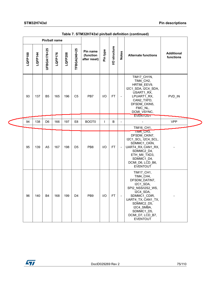

ICP/ICSP pin is located at which port number of STM32H753ZI MCU?
LPola
waclawek.jan
From the datasheet (this is for 'H743, look into datasheet of your mcu, it will be the same):0690X00000AQwq7QAD.png

In the AVR - or more precisely, the Atmel world, as it relates also to the serially-programable Atmel '51s (AT89S, AT89LP) - ISP was the term. I don't recall ever having heard ICP in this context. And, to me, ICSP invokes Microchip PICs, and should we go by analogy I'd then say the SWD pins are the in-circuit serial programming pins on the STM32.

STM32 can be programmed either using the debug interface - SWD or JTAG - or through bootloader. For former, review the Debug infrastructure chapter in Reference Manual (RM); for latter, refer to AN2606.
In-System Programming (ISP) and In-Application Programming (IAP) via on-chip boot loader software. To set forcefully in to boot loading mode through hardware, where can i found this pin in pin details of STM32H753ZI MCU?
waclawek.jan
