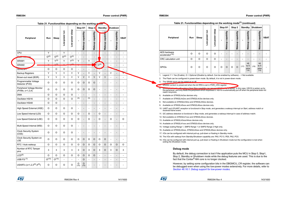

Iam using STM32L412 nucleo board. To achieve low power consumption Iam using standBy mode and RTC Wakeup. On wakeup I found that the data is not retained .

waclawek.jan
July 8, 2021
There is no BKPSRAM in the 'L4 family. Read the Reference Manual rather than some random web.

Thanks for the response. I have used the default hal function HAL_PWREx_EnableSRAM2ContentRetention() before entering standby mode to set the register as mentioned in reference manual . But still iam not able to preserve the contents and wakeup using RTC . Any other settings required for this?

waclawek.jan
July 20, 2021
Make sure var is located in SRAM2, and that the startup code does not overwrite it.
