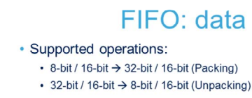

You dont want to try, what i recommended , so maybe good, you read about the DMA first :
https://www.st.com/resource/en/product_training/STM32F7_System_DMA.pdf
+ especially this:
And about audio processing:

I've read through the DMA data sheet and I'm still not sure how to configure this properly. I can get the audio working but I'm just not sure its entirely configured right.
The DMA only works for "word" transfer so I'm trying to make sure I'm using the start function correctly and then I'm processing the incoming data correctly into a single value.

2. About the data size: You transfer 24b data -> 32b word is received/stored (because this is a 32 bit cpu, not a DSP with 24 bit data paths for audio ), so just handle and store it as 32b word, not divide in two 16b parts and put these together then again; also just to do it more simple ( and faster ! ). But maybe you have also some reason to intentionally use 16b parts, you just didnt tell me (same as the "why only one sample" thing) - is there a reason ?
