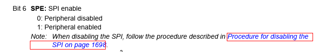

Unfortunately, it is not possible to reset the internal shift register of SPI after i have detected the stop condition (even not by disabling the peripheral).

the spi shift-counter should be reset, when spi is disabled.
try write to SPIxCR1 ->
there must be some way to reset the counter - otherwise you could never use spi again, if it got one spike on clk line or got one wrong sized word.

but the INT should be fast enough, to write direct to register Spixx->CR1 , disa. then enable , return. at 100MHz you have 10ns cycle, INT latency in CortexM4 is 12 cycles,
so after about 130ns you do the 2 instuctions, maybe 2x3 cycles, you done it in < 200ns.
(and you could clk even set higher...); with "HAL calls" no chance. :)
