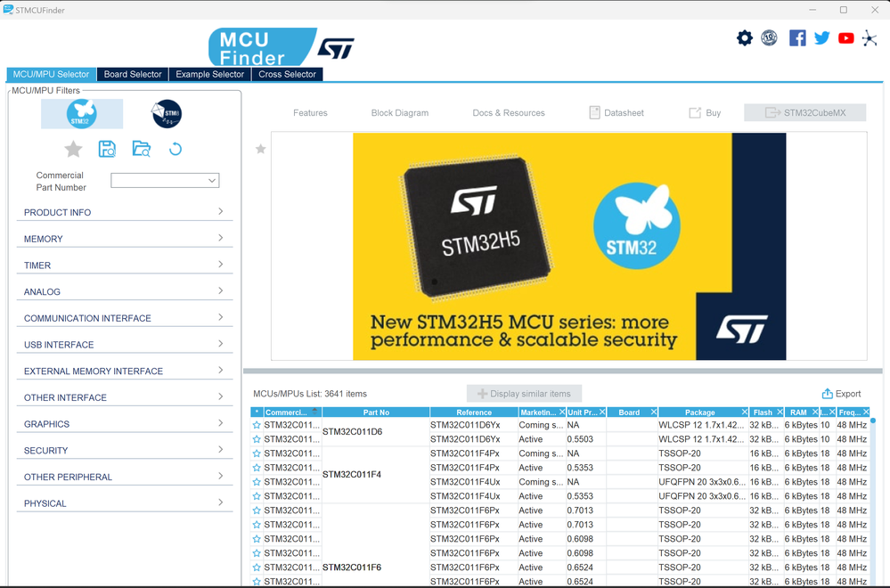

I'm trying to have a list of MCU with TSC (touch sensing) and Timer comparator with quadrature encoding features but it looks like these are not listed in MCU finder or CubeMX.
Is there a way to have this filtering?

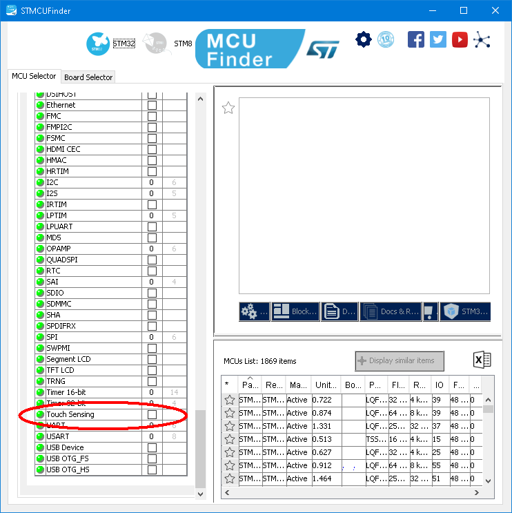

I have version 5.0 of MCU finder and there is no way for me to find "Touch Sensing" in the list of features of MCU Selector.
Even exploding every single group or searching with a search function.... I think it's really missing.

@Amel NASRI​ , hi, I have no idea whom to address this to... can somebody have a look at it? The option to select by TSC is missing from the new online selector, too, and I believe it's no coincidence. The selectors ought to have as much sorting options as possible to make them useful - that it's hard to do is a problem for ST to solve.
