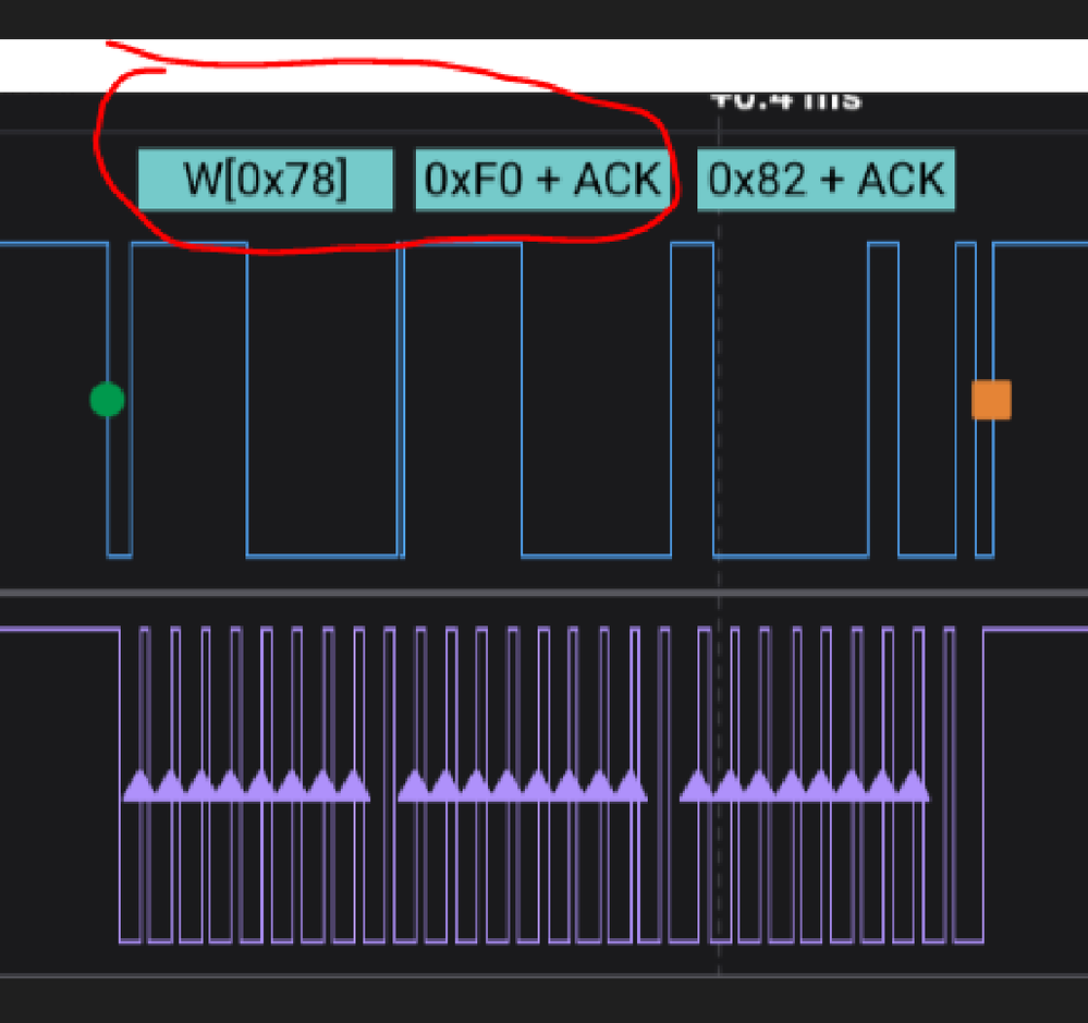

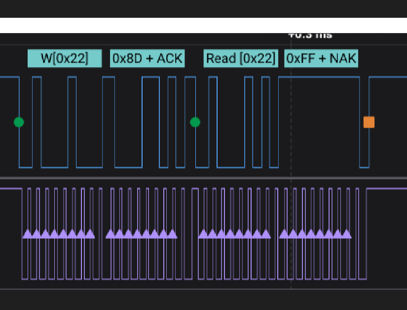

I have come across an odd situation in I2C communication between F405 and sensors
1) F405 is master. address is 7 Bit
2) with 3 slave I2C sensors , address, 22h,35h,78h
3) There is no issue to read data from sensors of 22h and 35h
but when communicate with 78h. after sending address 78h. another byte F0h is sent
The F0h is not expected.
any thoughts.
Thanks
Forest

2023-05-24 10:34 AM
Show your code (pasting code here using the button below that looks like "</>")
The extra 0xf0 looks like the FIRST byte of a 10-bit address, but obviously not appearing as the first byte. May just be a coincidence.

1) it used to work well in F3. but it does not work anymore in F4.
2) the sensor is https://www.ti.com/lit/ds/symlink/tmag5273.pdf
The reason is probably that it will be 0xF0 after shifting 0x78 +0 (write). The 0xF0 may cause confusing between 7bit and 10 bit address.
