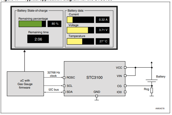

I want to know how to create a .exe software to communicate my STM32F446RE through USART
  • July 25, 2020
  • 7 replies
  • 2441 views
i want o create a .exe same like mentioned below,
its taken from :AN30640693W000003BI4oQAG.png
I want to create a software to communicate STM32F446RE through UART1 to change the UART2 parameter setting & to see the certain variable value Declare in code.
And then need to export that page of the Software as PDF.
