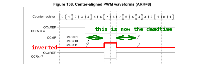

I want to add dead time to pwm signals generated in timer3 channels on STM32F407 Discovery. but i don't know how i can do it.
yan.11
I already know timer3 has not like timer 1 and 8 dead time generation featur. but maybe there is a way to add it!

berendi
Principal
The closest thing might be PWM center-aligned mode on two channels, either with inverted polarity on one channel, or PWM mode 1 on one channel and PWM mode 2 on the other.
