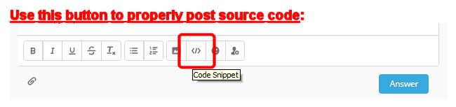

I think Andrew Neil was telling me that I shouldn't put a bunch of code into the body of my question, but that I should rather use the Code Snippet button. Is that correct? I will try to do it correctly next time!
-- Henry Heetderks
"I think Andrew Neil was telling me that I shouldn't put a bunch of code into the body of my question, but that I should rather use the Code Snippet button. Is that correct?"
Yes.
That way it gets properly formatted - doesn't lose indentation, etc.
This is common to (pretty much) all internet forums: https://www.avrfreaks.net/comment/2477336#comment-2477336
