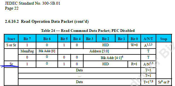

Hi ,
I tested  example " I3C_Controller_Private_Command_IT "  with  Controller  H503RB board
and  modified for JEDEC SMBUS for DDR5
( JEDEC smbus is more simple than MIPI I3C ,
No  DynAddrAssign function ,  Initially  I2C   after  CCC SetAASA ,  it change  I2C ==>  I3C )

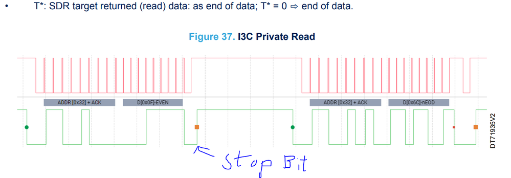

1.  CCC SetAASA   is OK ,   When I  read   register address 0x1  with I3C  1byte private read ,   I3C read value is  not   what i want .  Read value is  pointing   register  address  0x0 value and  fixed .  I think  there is a stop bit  in  Read protocol  and  after Stop bit , Internal read pointer in my chip is cleared
example an5879,  9.8 Private Read code ,  also  Stop Bit  in  I3C private Read  command
* It is JEDEC I3C Specification  ,  repeated start bit  , No Stop Bit  in  Read  Command
* example 9.8  code
2.  I  tried to change it when TX frame setting ,    but   Not cleared
 I3C_PRIVATE_WITH_ARB_STOP ==> I3C_PRIVATE_WITH_ARB_RESTART ,   MEND=0
Can  u tell me  how to do it ?
