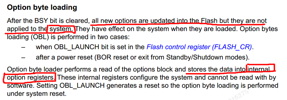

I check the reference manual and find some description as follow
0693W00000HrBZfQAN.pngI don't know how to understand internal option register. What is the difference between internal option register and Flash_OPTR I saw in the debug window?
I thought the Flash_OPTR like a display register, it's just a copy value of internal OPTR and direct modification is invalid. Only change internal OPTR will actually config the chip and I thought the internal OPTR was in ROM. It looks like I am wrong.
Please tell me the option bytes config procedure, when and where.
Didn't I already do that in my first reply? You need to launch the option bytes in order to apply them, as described in the "Option byte loading" section you've highlighted.
The OPTR registers provide the interface to the option bytes, not the option bytes themselves.
