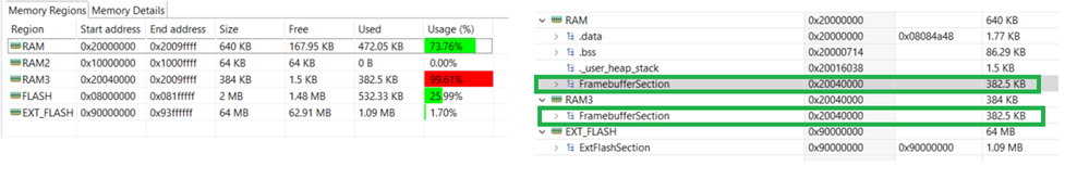

I'm using STML4R9ZI MCU and TouchFGX framework to implement my UI application. I have used 4' display, therefore required framebuffer size is 480 * 272. So question is how we can use the RAM3 section to hold framebuffer?
Ashvin Ramani
This MCU is having 3 RAM sections:
RAM : 640KB,
RAM2: 64KB,
RAM3: 384KB
I have modified my linker script(attached here) but don't know why the framebuffer is stored in RAM as well RAM3 section as per below snap?

Please help me to store the frame buffer in section RAM3 only as I want to use RAM/RAM2 for other operations.

Simple because RAM3 overlaps RAM.

Thank you @MM..1​ for taking my attention towards the memory map of this MCU.
This MCU has a total of 640KB(RAM1:192, RAM2: 64, and RAM:384).
