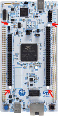

We are developing a baseboard for the NUCLEO-F767ZI and use the ZIO connectors. Right beneath CN9, CN8, CN10 and CN7, there are mounting holes
, that we want to use to make a robust mounting for industrial use. But the holes are very near and normal M3 screws, nuts, etc. will collide with the connectors.
What is inteded to be used therefore, normally?

@AAA  I believe the location of those holes is dictated by Arduino extensions standards, typically used for standoffs with screws installed on the board bottom side.
Johi
Senior III
Much depends on the type of headers you use, if you have the right brass spacers, a close but correct fit is possible.
