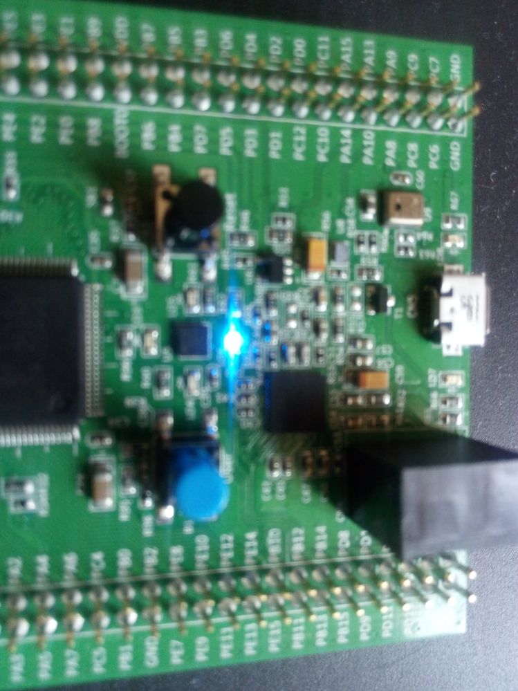

I'm trying to blink one led but two led blinks
ahmetgunduz
i'm trying to blink only one led. I have a problem with one of four leds. Because as you in my code, i'm trying to blink only 'green led'. But 'blue led' blinks also.

sorry, i think i couldn't explain problem clearly. With this code, here is the result. 0690X000009jne6QAA.jpg
And if ichange GPIO_PIN_12 to GPIO_PIN_15 (in line 9 and 11) i see that
The problem with the implementation is that the local/auto variables are allocated from the stack, and don't have explicit initialization. The result is that the structure can contain random junk and this subsequently gets injected into the peripheral configuration registers, undefined/unexpected behaviour can then occur.
By clearing the structure the behaviour becomes significantly more predictable. Generally it is advisable to initialize all fields in a structure that down stream code might depend upon.
