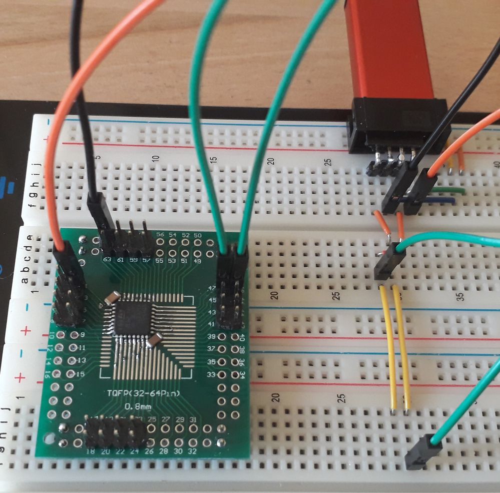

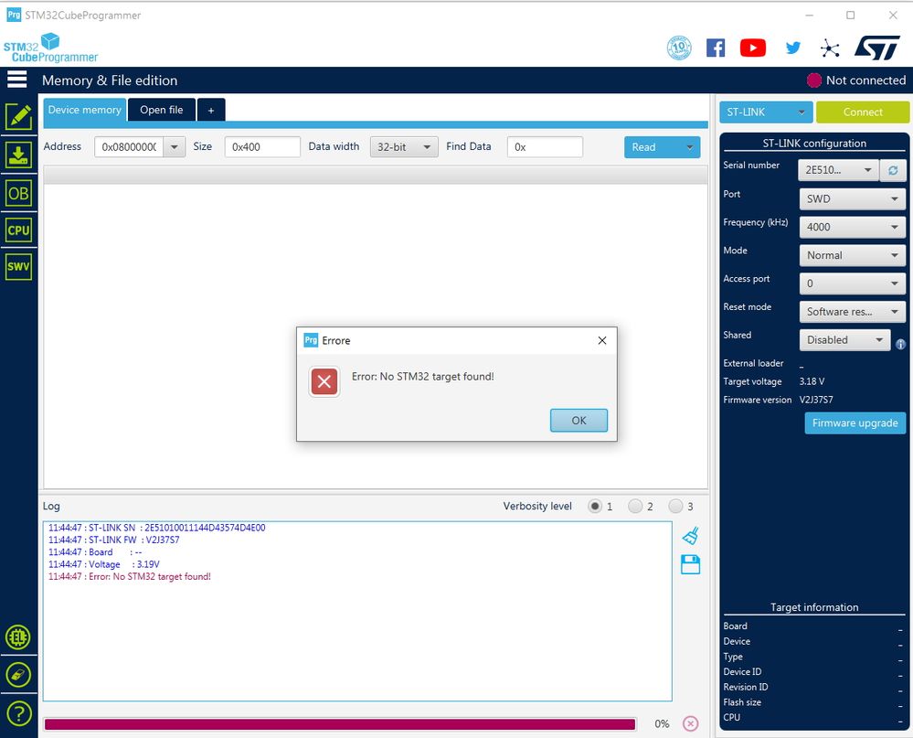

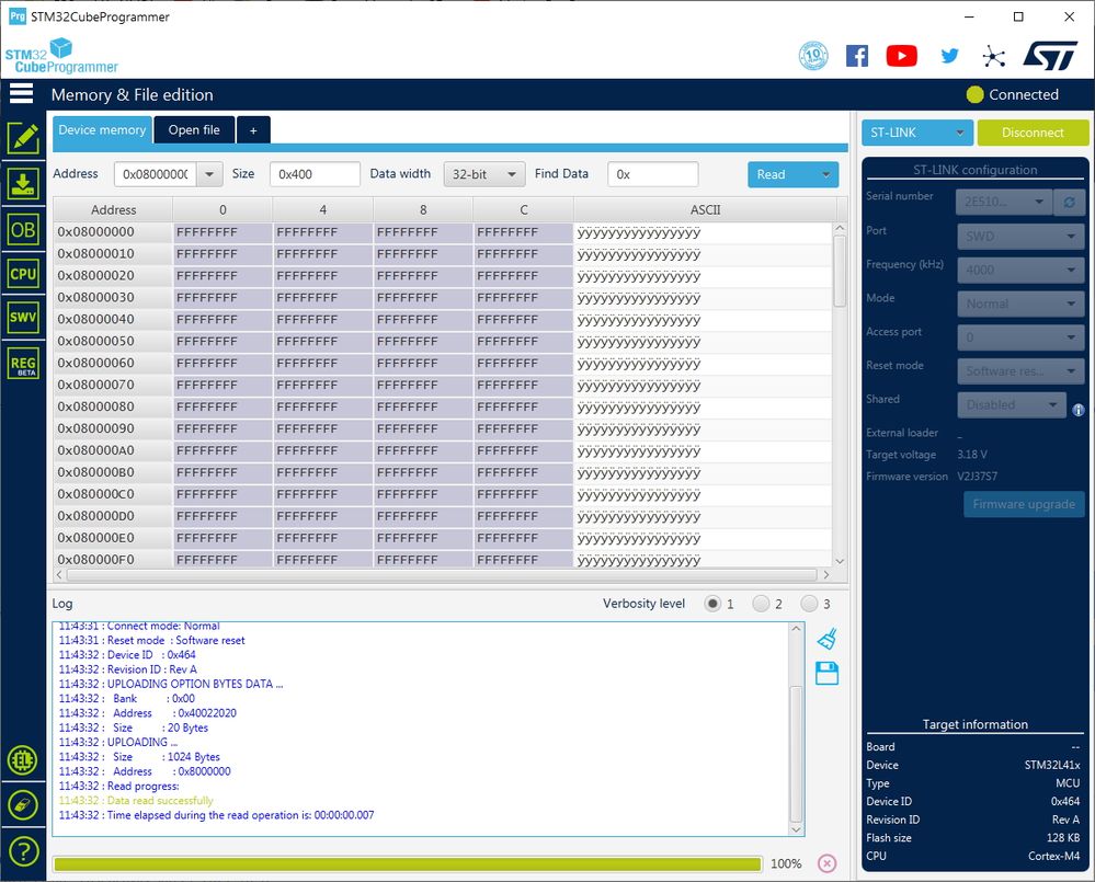

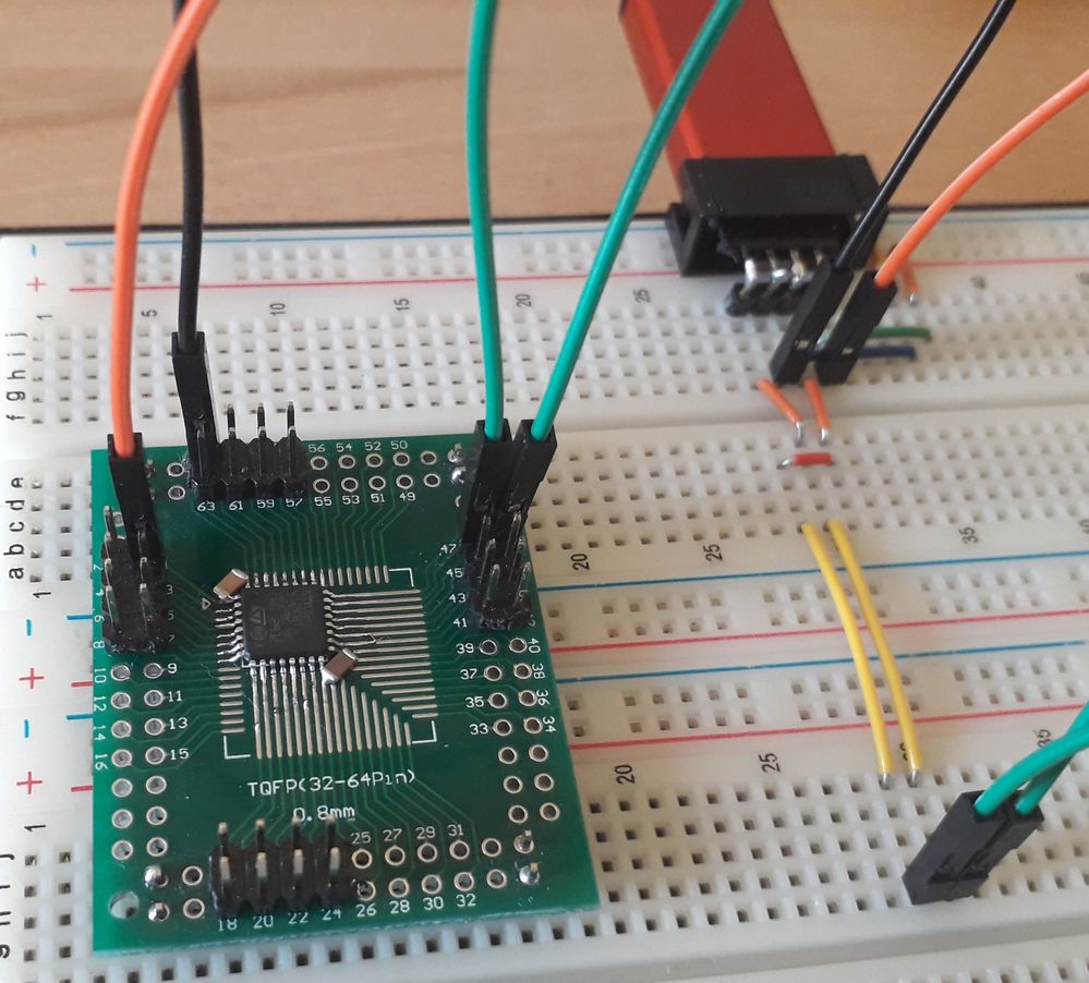

I'm going crazy, look at the photos: if I move the SWD CLK connection in one point of the breadboard the connection works, in another it doesn't! The chip is a STM32L412KB, I tried to replace it but nothing! I also replaced the ST-LINK but nothing yet.

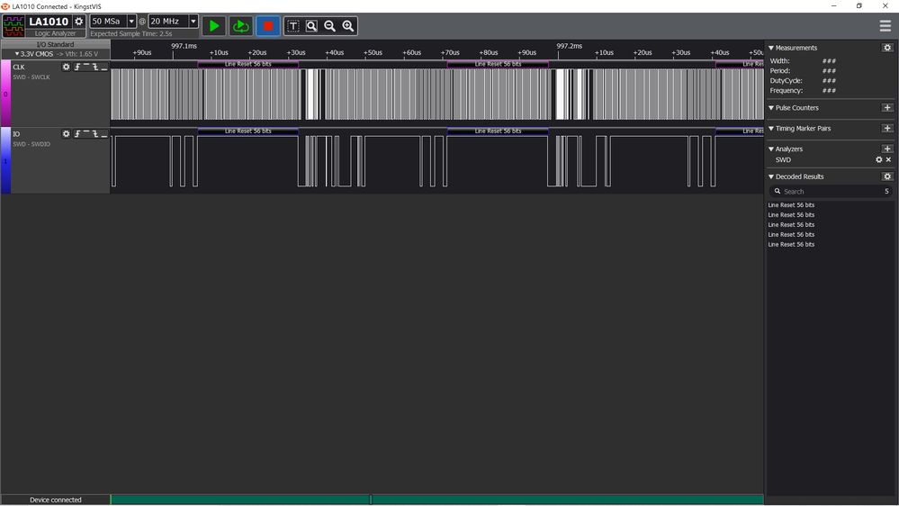

Check signal with scope ​

  1. That is not a genuine ST-LINK, but a Chinese clone. Who knows how reliable it is...
  2. The shorter path works, while the longer one with two additional connections doesn't - nothing crazy.
  3. Try lower SWD frequencies.

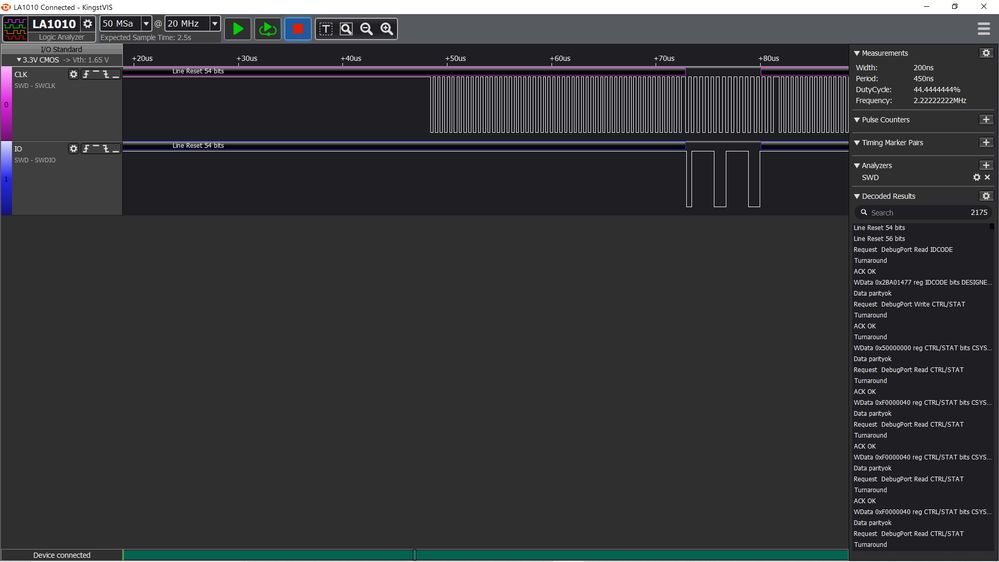

... Check signal with scope
It seems that the MC is not responding in the second position of the breadboard.
first:0693W000008y6xVQAQ.jpgsecond:

  2. in reality if I keep the same length as in the second case but I change the final position in some cases it works. This drives me crazy :)
  3. i tried up to 15 khz, nothing to do
  1. I mean you need connect under reset , but this clone dont have this prepared, need little change
  2. your board have crazy connection remove it from universal and connect wires directly GND 3V3 SWCLK SWIO
  1. Could you please explain to me what these changes are?
  2. unfortunately if I directly connect stlink to the MC it works but as soon as I connect the other pins to the breadboard it stops working
