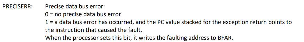

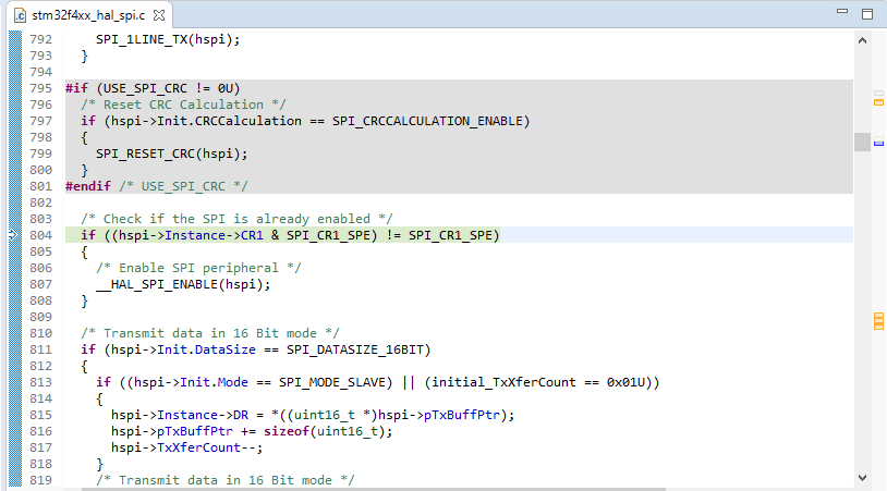

My code is using the ST routine "HAL_SPI_Transmit" many times but it always run down at the same location in this ST routine.. (picture 1 & 2) (btw each times the routine is used to access a flash memory 1 Mbit SPI Serial Flash SST25VF010A).

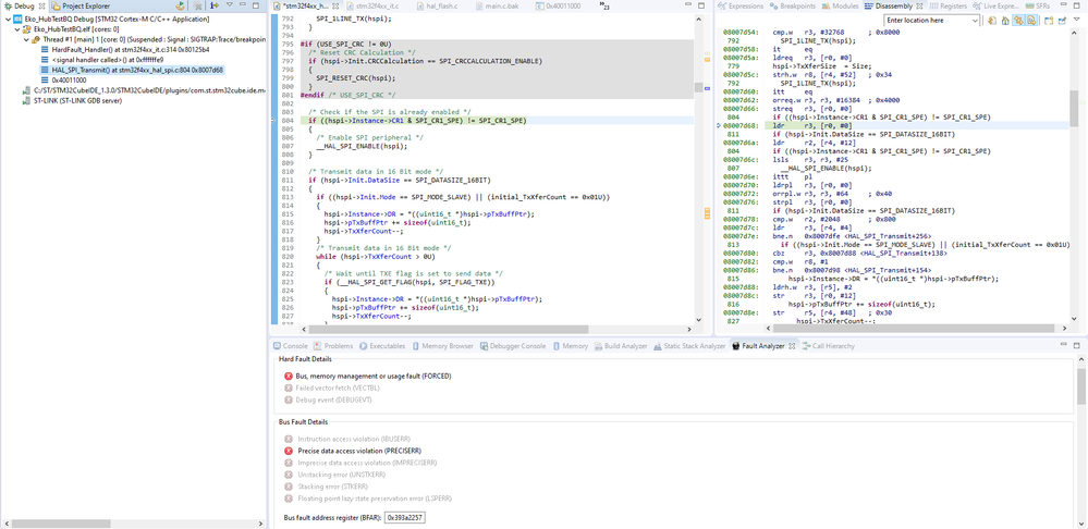

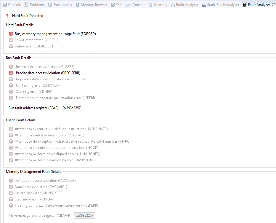

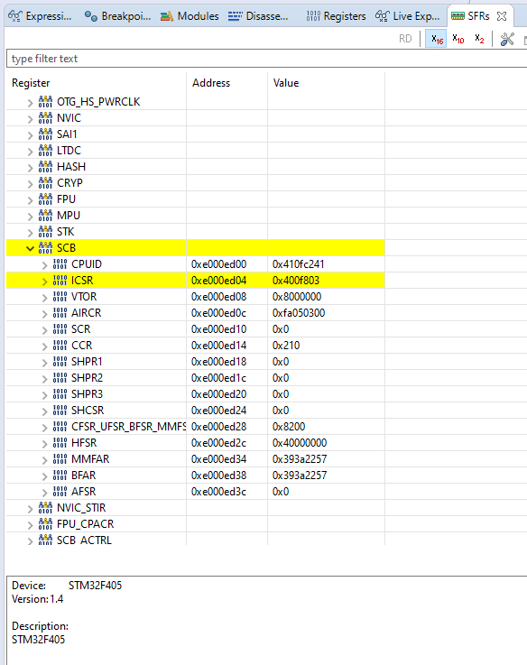

So, I've investigate on the issue and I found that was a "bus fault" "PRECISERR" and "FORCED" (picture 3, 4 & 5).
