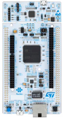

Hello again:
You said:
@DietWall wrote:
Hi @TDK
The board is not custom, it´s the eval board STM32F767 from the link above.
Do you mean this one?

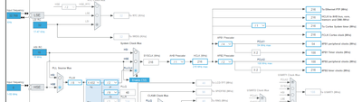

This is SystemClock_Config:
void SystemClock_Config(void)
  RCC_ClkInitTypeDef RCC_ClkInitStruct;
  RCC_OscInitTypeDef RCC_OscInitStruct;
  /* Enable HSE Oscillator and activate PLL with HSE as source */
  RCC_OscInitStruct.OscillatorType = RCC_OSCILLATORTYPE_HSE;
  RCC_OscInitStruct.HSEState = RCC_HSE_BYPASS;
  RCC_OscInitStruct.HSIState = RCC_HSI_OFF;
  RCC_OscInitStruct.PLL.PLLSource = RCC_PLLSOURCE_HSE;
  RCC_OscInitStruct.PLL.PLLM = 8;
  RCC_OscInitStruct.PLL.PLLN = 432;
  RCC_OscInitStruct.PLL.PLLP = RCC_PLLP_DIV2;
  RCC_OscInitStruct.PLL.PLLQ = 9;
  RCC_OscInitStruct.PLL.PLLR = 7;
  if(HAL_RCC_OscConfig(&RCC_OscInitStruct) != HAL_OK)
    while(1) {};
  /* Activate the OverDrive to reach the 216 Mhz Frequency */
  if(HAL_PWREx_EnableOverDrive() != HAL_OK)
    while(1) {};
  /* Select PLL as system clock source and configure the HCLK, PCLK1 and PCLK2
     clocks dividers */
  RCC_ClkInitStruct.ClockType = (RCC_CLOCKTYPE_SYSCLK | RCC_CLOCKTYPE_HCLK | RCC_CLOCKTYPE_PCLK1 | RCC_CLOCKTYPE_PCLK2);
  RCC_ClkInitStruct.APB1CLKDivider = RCC_HCLK_DIV4;
  RCC_ClkInitStruct.APB2CLKDivider = RCC_HCLK_DIV2;
  if(HAL_RCC_ClockConfig(&RCC_ClkInitStruct, FLASH_LATENCY_7) != HAL_OK)
    while(1) {};
yes, this looks very similar. I just looked it up:
Board Model is: Nucleo-F767ZI.
MCU is STM32F767ZIT6U
Yes it's the Nucleo-F767ZI. It's a Nucleo board not an Eval board.
Ok I don't see an issue in your system clock config. Doing the exercise in CubeMx:
It looks good.
