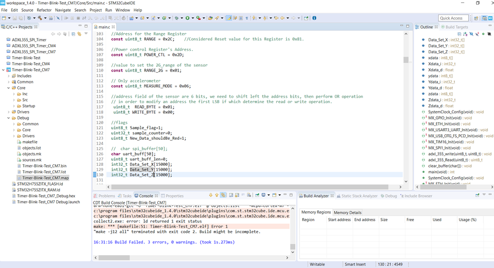

I have 3 errors and I don't know what is the problem . I use Stm32h755ZIQ with 1MB of Ram and 2MB of Flash .
STork.1
5 REPLIES 5
Peter BENSCH

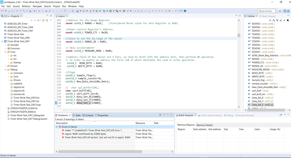

Not much information is visible on the screenshot you provided. Please select tab Problems in the bottom part of the window to get more information regarding the errors.
STork.1
0693W000005AWWFQA4.pngThanks for your feedback, in the screenshot below the problems are shown but I wonder because the available RAM size for user according to the data-sheet of the MCU is 1MB and more than 800MB are available for user. those global variables I defined just take up 450 MB space . for my application, it is critical to store all data-samples in Ram first, then send them to a WiFi module then clear the buffer to do it again once each hour.
You're going to have to look at the Linker Scripts (.LD). The RAM is NOT all contiguous, you might have to make decisions about which to use based on speed and distance from the core, and how critical any particular data structure is.

I checked the .ld file or the linker script. Since My code is generated by the STM32 Cube MX, my file is named STM32H755ZITX_RAM.ld.
Here is the content of the file:

Since I am pretty new with this topic, I could not exactly understand what should I do and which part should I probably change.
I did some search and ina web-site somebody told if we define the array like this, the overflow error will be removed.
uint8_t buffer2[64000] __attribute__((section(".ccmram")));
Could you please tell me that what does it mean ? what should I do if I want to store three buffer the overall size of which are around 500KB?
what is ccram and which part of my RAM is consisted of ccram ?
thank you.
For memory specifications read the reference manual.
