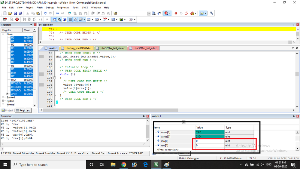

I cant access ADC values from DMA buffer into any other variable in while loop. DMA buffer have values in it but not going into other variable. Can anyone tell me where im wrong????

uint32_t value[2];
uint32_t raw[2];

HAL_ADC_Start_DMA(&hadc1,value,2);
 /* USER CODE END 2 */
 /* Infinite loop */
 /* USER CODE BEGIN WHILE */
 while (1)
  /* USER CODE END WHILE */
value[0]=raw[0];
value[1]=raw[1];

waclawek.jan
Qualify the DMA buffer as volatile.
2 REPLIES 2
waclawek.jan
Thanks for Reply .... yes it works after take buffer as volatile and for make it working properly i also slow down sampling.
