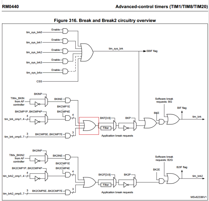

I am learning the adv_timer module in the RM0440 document. Is there any error in the OR logic gate in the screenshot?

waclawek.jan
Why do you think so?
If any of the break signals is active, the result is active. That's OR for me.
Cfang.1
Because we think TIMx_BKIN , tim_brk_cmp1..4,tim_brk_cmp5..7 is active low after system reset.
