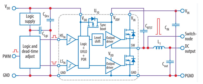

Thanks for your reply. I have gone through AN4539.I am using HRTIM to provide PWM signals for DC-DC converter EPC2152. Which signals of HRTIM I should use for the same? Currently, I am using HRTIM_CHA1, HRTIM_CHA2. Should I use any other signals like HRTIM_FLTX or HRTIM_EEVx for my application. What is the purpose of these signals (HRTIM_FLTX or HRTIM_EEVx)?
EAbra.3
Please find the design of DC-DC converter EPC2152. As per this diagram HRTIM_CHA1 should be connected to HSIN and HRTIM_CHA2 should be connected to LSIN. Please advise me on using other HRTIMER signals.0693W00000WIb4TQAT.png

I just saw that this topic regarding the EPC2152 has already been partially addressed in another thread.
