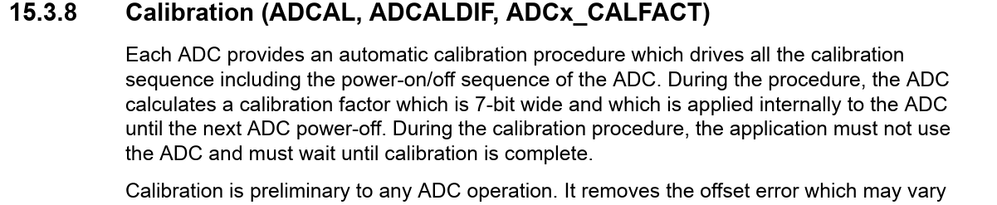

AScha.3
did you calibrate ADC ? need it first... see:
0693W00000VORAjQAP.pngso: first calibrate, wait, enable , wait , -> ready. set ADC channel, start ADC.

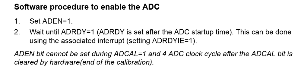

looking at this i tried to divide by 2 the clock frequency of the ADC and it worked. So thanks a lot!
I had the same problem with the STM32L431RCT6. ADRDY bit in ISR was never set after enabling. This caused the DMA to keep reading zeros from the ADC. It didn't work with prescaler set to 32 or 64, but it did sometimes work with 16. Slightly reordering the code, adding some delays or adding breakpoints at certain places would also affect this issue and either fix it or cause it to happen again. My workaround was to simply keep trying to set ADEN. Not pretty, but it works for all clock settings now!
// doesn't always work directly after calibration, so keep trying
while(LL_ADC_IsActiveFlag_ADRDY(ADC1) == 0)
	LL_ADC_Enable(ADC1);
Edit: ST has a define LL_ADC_DELAY_CALIB_ENABLE_ADC_CYCLES. It doesn't use this delay in generated code. But if you delay this number of ADC cycles after calibration the enable seems to work. But you still need to wait for the active flag to turn high before you can use the ADC. So I kept the code just in case
