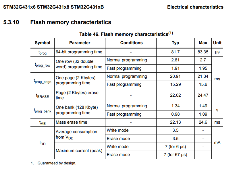

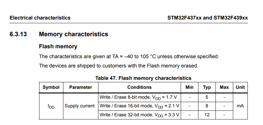

Now, back to EEPROM Emulation, the only Extra consumption versus Normal run mode is the Power consumption of our Flash ( Erase/Write procedure) in a continous way and is about 7mA in G431 and up to 12mA in STM32F429.

Thank you @STOne-32 for this condensed reminder of the nominal conditions and right pages of the daatshet.
Concerning the hardware, I use JP6 on the NUCLEO STM32G431RB to insert my ammeter. JP6 is there for that purpose (to measure Idd). I have checked the ammeter.The abnormal consumption does not depend on the loaded code, so I guess a simple while () will do the same, but nevertheless I can try. I'll keep you informed in case of any progression.
