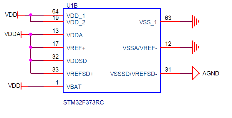

My MCU does not work. I guess it is oscillator problem.
- PF1 pin of STM32F373RC is low even though 3.3V power is supplied to MCU, so 8Mhz oscillator does not work.
- The oscillator has internal capacitors and part number is "CSTNE8M00G550000R0"
- I designed this circuit board. I used MCUs of Atmel, TI and Microchip for several years but this is first time to use STM32 MCU.
- I checked 3.3V power is normal and NRST pin value is HIGH.
- There is no other oscillator for LSE
Did I make a mistake?
Please let me know some way how can I check this issue.
Attached image is oscillator part of my circuit.

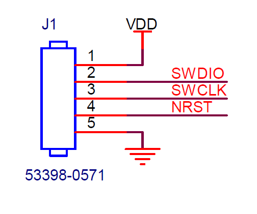

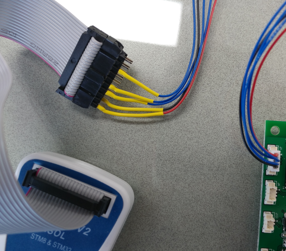

I'm using TRUE studio and ST-LINK/V2-ISOL emulator. Actually I think there is little possibility that emulator connection or TRUE studio setting has some problem.
Attached images are emulator connection

Check level of NRST
Make sure you have VDDA connected to a supply
Power/wiring of SWD looks ok.
Check part orientation.
Secondary signs-of-life is to wire up USART1 PA9/PA10, when reset with BOOT0=HIGH you should be able to send an 0x7F pattern at 9600 8E1 (Even Parity) and get a 0x79 response. Use something like RealTerm in HEX mode.
If this is also not responsive check all supply pins. Double check part orientation.

Power connection of mcu is same as attached image. I checked every power pins by scope
Part orientation is ok, actually it is assembled by SMT not by hand
Unfortunately It is hard to check USART1. it is connected to bluetooth module already... Is there another way? I have usb port in my circuit and USART2 is available.
I found something strange while checking NRST level
Voltage of these pins are changed after trying download firmware by emulator
First value is measured before connect emulator, second value is measured after download is tried.
SWDIO: 3.3V --> 3.3V
SWCLK: 0V --> 2.4V
NRST: 3.3V --> 2.8V
NRST and other values become normal after emulator connector is detached. My emulator has some problem?

Make sure that you follow all recommendations provided in the hardware getting started of the STM32F373. The power scheme is particular as there are the VDDSD available only this line STM32F3 family.
You need to refer to AN4206 (Getting started with STM32F3 series hardware development).

By the way I solved this issue. The problem was my emulator. I tried downloading firmware with Nucleo board as emulator and it worked well.
