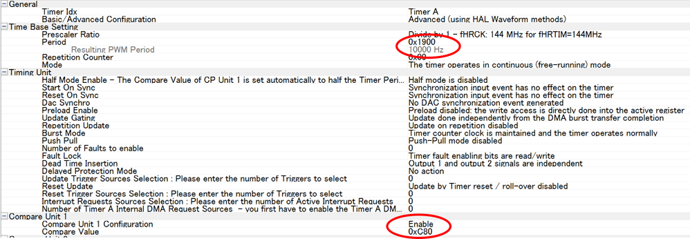

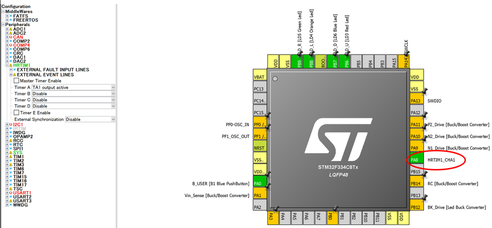

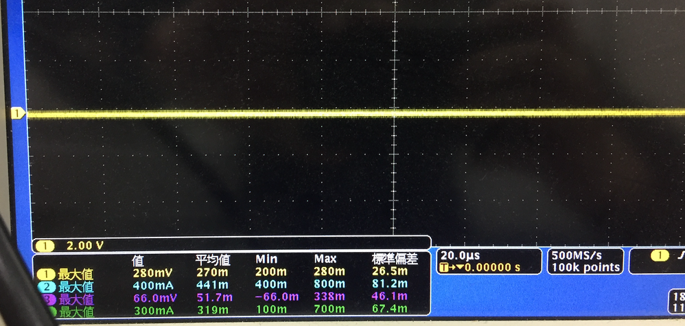

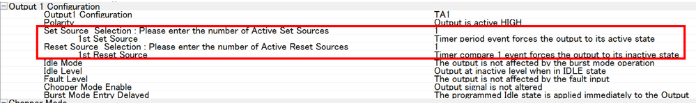

HRTIM does not work. I set up config as shown below.
0690X00000606nNQAQ.png0690X00000606nOQAQ.png0690X00000606ncQAA.png0690X00000606nXQAQ.png

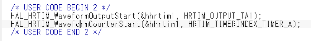

And, I wrote a program as shown below.
But

The functionHAL_HRTIM_WaveformCounterStart should take as parameter a combination of following values:HRTIM_TIMERID_MASTER,HRTIM_TIMERID_TIMER_A,HRTIM_TIMERID_TIMER_B,HRTIM_TIMERID_TIMER_C,HRTIM_TIMERID_TIMER_D,HRTIM_TIMERID_TIMER_E.
Please fix the call of this function in your code then try again.

Posted on April 20, 2017 at 10:28
Thank you very much. HRTIM work. If I were thinking by myself, I would not have noticed it. I was indebted to you.
