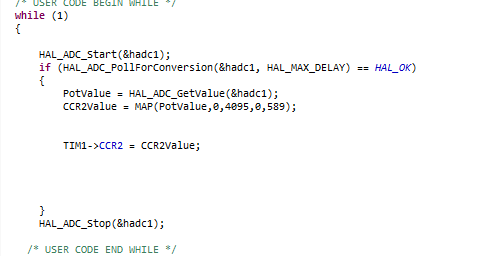

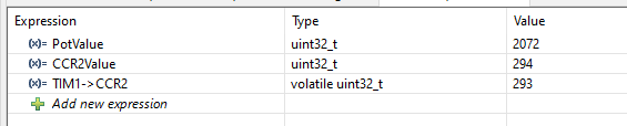

how to write on the CCR2 register.
abodi.1
3 REPLIES 3
Please edit with a better title.
Is this with the STM32F412ZG from before?
Are you getting any output from TIM1 ?
What about all the other register in TIM1, can you see them, are they all zero?
Is the TIM1 clock enabled?
abodi.1

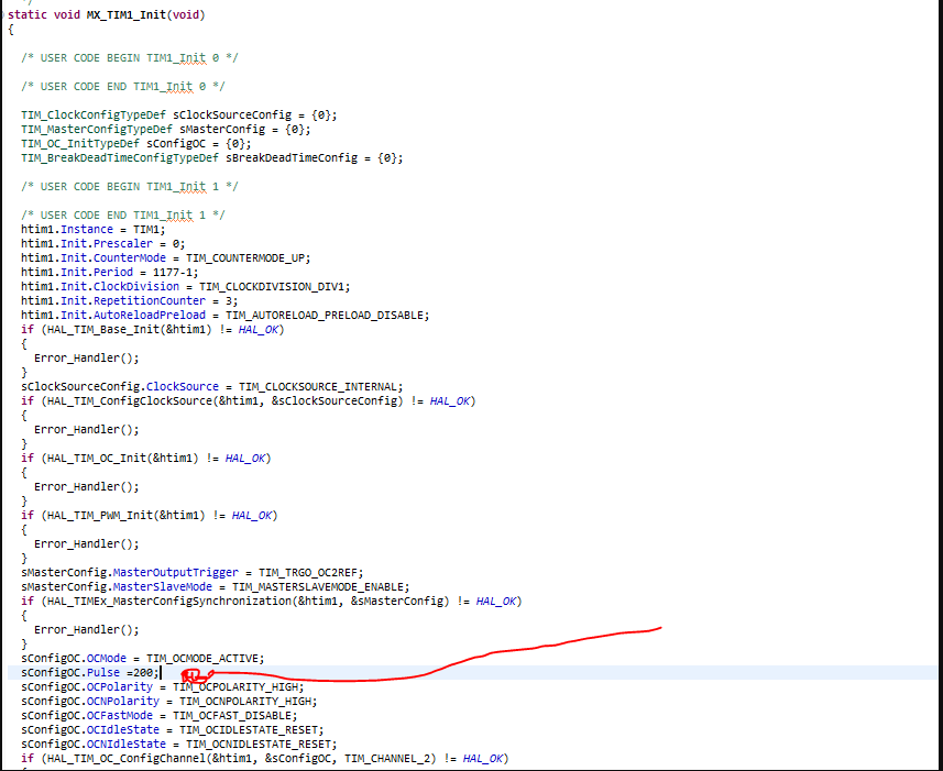

Yes it is active when
 I enter a value directly on here "" sConfigOC.Pulse = 250;"". it just takes the value set at the beginning.thank you
Dump all TIM1 registers
Perhaps get a UART working, and print the value out of the ADC and MAP function.
Does the ADC need to start/stop constantly?
