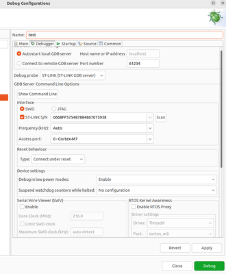

I am using the STM32F767ZI MCU and was wondering if it is possible to check if a debugger is connected or not and if SWV is enabled, to avoid the UN-necessary looping when a printf is encountered.
These are my requirements:
  1. Check if the user has connected a debugger
  2. Check if the user has enabled ITM trace from the debugger and connected to the correct port.(Port 0 in this case)
  3. If both points 1 & 2 are not done, avoid the looping when a printf is encountered.
So when printf is called it invokes the _write function. Inside the write function we call ITM_SendChar(); in a loop. It is this loop which i want to avoid.

IsDebuggerAttached works are i am able to recognize if the debugger is connected or not by checking the DHCSR register.
But i am not able to check if SWV is enabled and the correct port is connected.
To test this , i disabled the SWV from the debug configurations, but the LED did not light up, and when i placed a break-point on ITM_SendChar(), it hit that breakpoint.
Any help would be appreciated.

Checking DHCSR.DEBUGEN does confirm debugger presence, but in my use case, that alone isn’t enough.
The issue I’m tackling is that even with a debugger connected, ITM/SWV tracing might not be enabled or configured properly. In such cases, calls to ITM_SendChar() inside _write() will still run inside the for loop — wasting CPU cycles even though nothing gets output via SWV.
So I also tried checking:
  • ITM_TCR.ITMENA (ITM master enable),
  • and ITM_TER[0] (to check if stimulus port 0 is enabled).
However, these registers still report as enabled, even when the trace output isn’t showing up — i.e., the SWV output window in the debugger remains blank. So the condition passes, but no actual data is transmitted. That’s what led me to post this question in the first place.
