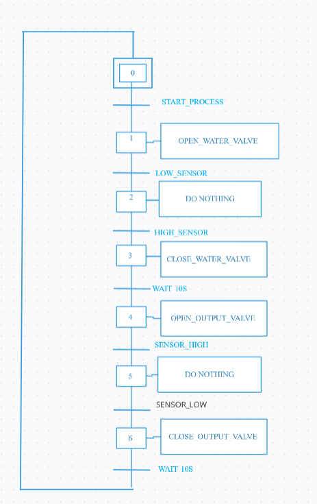

Hey,
I'm basicly filling a tank with liquid and I have 2 level sensors in this tank.
These level sensors are connected to GPIO_EXTI of my MCU so when the water reached the sensor level, an interrupt occure.
If the tank is filling or emptying, I must disable the water input regarding to which level the water is (low if emptying or high if filling).
The interruption routine :
void HAL_GPIO_EXTI_Rising_Callback(uint16_t GPIO_Pin){
	/* Sensor 1 (lower level) interrupt */
	if(GPIO_Pin == WATER_SENSOR_LOW_Pin){
		if(isEmptying){
		        StopWaterInput();
	/* Sensor 2 (upper level) interrupt */
	else if(GPIO_Pin == WATER_SENSOR_HIGH_Pin){
		if(isFilling){
		        StopWaterOutput();
I need to code a cycle like this :
void Process(){
   //Start Fillling the tank
   isFilling = 1;
   isEmptying = 0;
   StartWaterFlowing();
   //Water reach low sensor, do nothing
   //Water reach high sensor and so the water input is closed (IR callback)
   //NEED TO HAVE CLOSED THE WATER INPUT TO CONTINUE
   HAL_Delay(5000);
   //Start emptying the tank
   isFilling = 0;
   isEmptying = 1;
   StartTankEmptying();
   //Water reach high sensor, do nothing
   //Water reach low sensor and so the water output is closed (IR callback)
  //NEED TO HAVE CLOSED THE WATER OUTPUT TO CONTINUE
0693W00000aI9YHQA0.pngI don't know how to do for the code to not start emptying the tank until the water reached the high level and reciprocally not start the cycle again until the water reached the low level.
I've read a bit about WFI but I'm not sure that's what I need. I'm also new to thread programming so maybe I need to build the code differently to use thread.
Do you have any suggestion how to acheive this ?
Thanks for your help.
Adrien

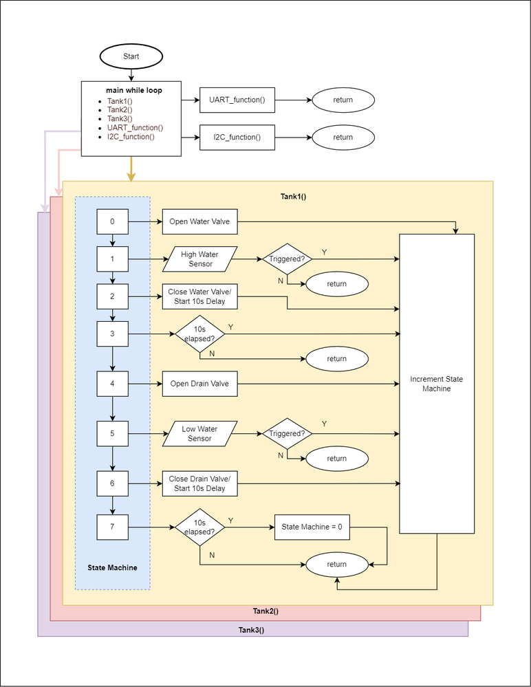

Karl Yamashita
Lead III
@ADesp.1​
As @KnarfB​ mentioned, a state machine would work. You can create a function that accepts a structure data so you can have multiple instances of tanks. Call it from a main while loop and you can do other tasks along with the tank(s). See image to get an idea.
I took up your challenge :grinning_face: so I wrote working code on a STM32F407-DISCO board. I'm using the LED's for indicators for water/drain valves and high/low sensors.
I'm going to make a YouTube tutorial on it. I was using a 4x4 button pad but I had wires going over the LED's so it was hard to seem them work. So I ordered a 4 button Click board and I'm waiting for the shipment to arrive.
Here is the state machine.

If smoke escapes your device, put the smoke back in. It'll still work as a conversation piece. If you find my answers useful, click the Accept as Solution button so that way others can see the solution.
Hey, thanks for this answer.
I think this could help a lot, but I migth put the WaitForHigh/CloseValve states in the interruption routine. I do want a lot of precision in the volume control process.
I didn't do a lot of MCU programming so far and I 've never seen this state machine way of coding, I think it's pretty cool.
In the code you increment stateMachine by one at the end of every state. But in the switch case you have an String. What is stateMachine ?
Thx
Karl Yamashita
Lead III
You never want to do anything from within an interrupt routine unless it's a simple GPIO control. You want to set a flag and get out so that other interrupts can work. Plus, the close valve will happen within nano seconds unless you have blocking or inefficient code for other tasks.
stateMachine is just a variable for the tank instance. The cases are enums.
