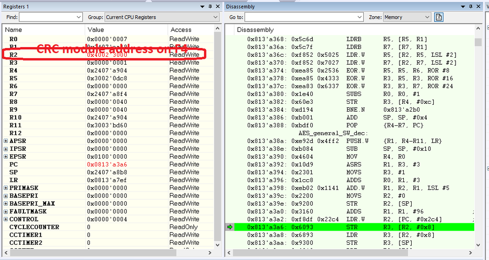

I tried to use the crypto library "STM32CryptographicV3.1.1_STM32H7_IARv8_otnsc.a" on the M4-core of the STM32H757 but I got some troubles as explain below.
First of all, I'm using IAR 9.10 and I haven't problem when using the library on M7-core.
When using on M4, the IAR linker call a FPU double precision library instead of FPU single precision library. As a consequence, I got hard faults on some basics calcul such "f32Value * 2.5" because this calcul contains double precision instructions that are not support by M4.
I assume, IAR linker is calling FPU double precision library because the crypto library for STM32H7 has been compiled for M7 with FPU double-precision option activate. Is it correct?

There are indeed different libraries for M4 or M7. However, it seems the librairies are MCU dependents because they are using the CRC module. When I used the M4 crypto library "STM32CryptographicV3.1.1_CM4_IARv8_otnsc.a", I got another hard fault when calling the CRYPTO_AES_Cbc_Decrypt function because the CRC module is not map at the correct address (F4 - 0x4002'3000, H7 - 0x5802'4C00).

I reused the STM32CryptographicV3.1.1_CM4_IARv8_otnsc.a & STM32CryptographicV3.0.0_CM4_IAR_otnsc.a.on the M4-core of the H757 but as I explained it seems to use the CRC module. The CRC module boundary address is different between a STM32H7 and a STM32F4. .As you can see in the enclosed picture, the register R2 contains the address of the CRC module of the F4 MCU (0x40023000). After this instruction an hardware fault occurs because the code try to access to unknown address/register. The CRC module on STM32H7 is mapped at 0x58024C00. It's the address implemented in STM32CryptographicV3.1.1_STM32H7_IARv8_otnsc.a library. (see embedded picture)

Regarding V4 usage, there is an autodetection of the running STM32.
If you use the CM4 version of the library and call cmox_initialize with pInitArg = NULL or pInitArg->target = CMOX_INIT_TARGET_AUTO, it will go to the detection process and determine it's running on an H7.
Thus use the right CRC address.
User can also directly set the STM32 in use by setting: pInitArg->target = CMOX_INIT_TARGET_H7
I didn't checked yet by myself but I'm sure it will work :)
