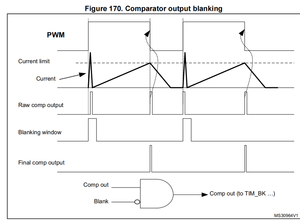

How to use OCREF_CLR (COMP1 AS OCREF_CLR),I found it not work correctly.(STM32G431C8t6).When comp1 is in blanking mode,the pwm is low(it should be high).

waclawek.jan
When OCREF_CLR is active, OCREF goes to zero, regardless of current Mode, and remains at zero until the next Update event. That means, that the respective TIMx_CHx output goes to the level given only by TIMx_CCER.CCxP polarity bit.
You have set the clear to TIM3_CH2, and TIM3_CCER.CC2P = 0, that's why the TIM3_CH2 pin goes low when the clearing event occurs.
When comp1 is in the stage of blanking, the output of comp1 is low, so TIM3_CH2 remains high. Only after the the stage of blanking, the output of comp1 (high), the OCREF goes to zero, then TIM3_CH2 pin goes low.
waclawek.jan
I'm not expert on the COMP/OCREF_CLR mechanism, but why do you think this is incorrect?
The OCREF_CLR works only when the signal(Final comp output) is high. In blanking window, final comp output is low, so TIM3_CH2 remains its initial value high.
