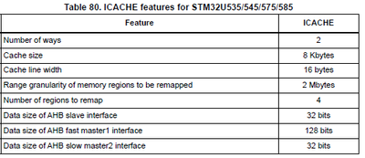

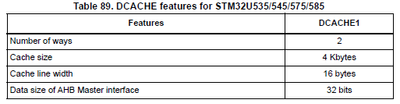

Hi @Skfir ,
The STM32U5 embeds an instruction cache (ICACHE) and a data cache (DCACHE).
The ICACHE is introduced on C-AHB code bus of Cortex-M33 processor to improve performance when fetching instruction and data from internal and external memories.
The DCACHE is introduced on S-AHB system bus of Cortex-M33 processor, or on an AHB bus driven by a master peripheral, to improve the performance of data traffic to/from external memories only.
Depending on which STM32U5 you have the features of ICACHE and DCACHE might be different. Here are the features for STM32U575 devices.
