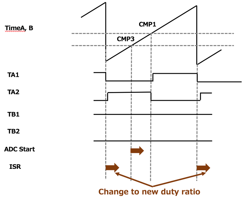

I want to use
Interrupt Service Routine(ISR)
 as shown in the picture below. So I want to use HAL_HRTIM_IRQHandler.0690X00000607GUQAY.png

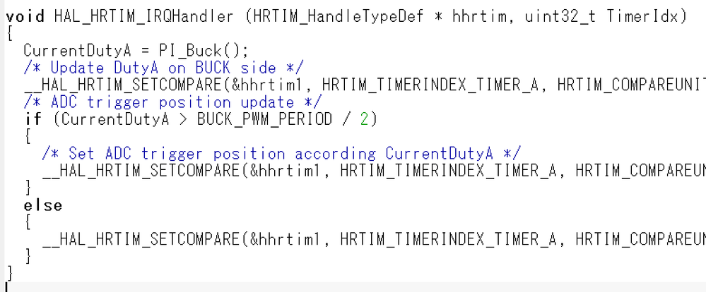

I wrote the program as shown below, but I got an error.
