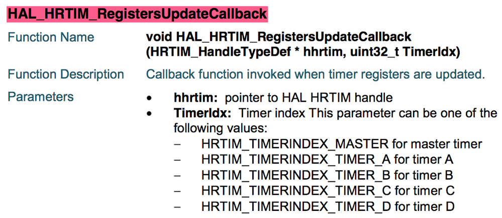

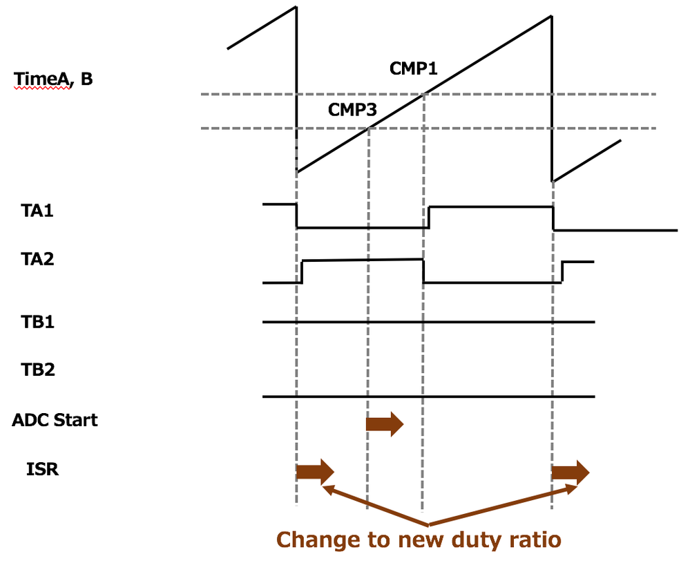

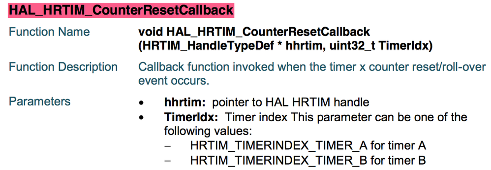

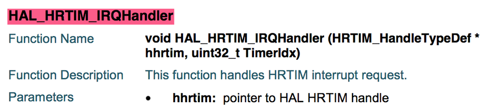

I want to use
Interrupt Service Routine(ISR)
 as shown in the picture below. So I want to use HAL_HRTIM_RegistersUpdateCallback or HAL_HRTIM_CounterResetCallback or HAL_HRTIM_IRQHandler. 0690X00000607GHQAY.png
Which one should I use? How do I examine it? According to �UM1786 User Manual Description of STM32F3 HAL and Low-layer drivers'', it is written as follows. But I can't understand Difference between HAL_HRTIM_RegistersUpdateCallback, HAL_HRTIM_CounterResetCallback and HAL_HRTIM_IRQHandler.
