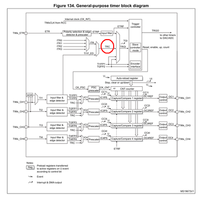

Hello All,
I want to trigger an input capture when another timer overflows. I have both timers set up, but I am missing on how to make the overflow event trigger the input capture of the other timer. The reference manual has been a good help, but I can't figure out how to connect the two timers.

Hello @Banana123,
Set up the master timer to generate an update event (UEV) on overflow. This is typically done by enabling the counter and allowing it to run until it overflows, which generates an update event.
For the slave timer, select the appropriate trigger input source (e.g., ITR0 if the master timer is TIM1, check TIMx internal connection tables in RM )
‎2024-05-16 2:08 AM
- in master timer, select 0b010 for Update as TRGO source in TIMx_CR2.MMS
- in slave timer, select the appropriate trigger source in TIMx_SMCR.TS as @Sarra.S said above
- in slave timer, in TIMx_CCMRx.CCxS for the channel you want to capture on, select 0b11 for "mapped on TRC"

It is working, thank you very much!
What is the purpose of the TRC bits? From the manual, I got that the bits do different things in different setups, but I couldn't find why this is necessary here or what TRC even stands for.

I'm not exactly sure, but I would say TRC typically stands for trigger control.
Mapping to TRC is necessary when you want the timer to react to an internal trigger signal rather than a simple external input or clock signal, which is typically other timers within the microcontroller
