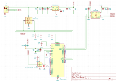

We have a STM32070CBT6 with minimal connections (schematic below) and it appears to be unresponsive to USB enumeration, although it does pull DP low to trigger it. This occurs when hotplugging it or holding reset low for a few seconds. I've checked the input on PF0 and it is getting a clean 16 MHz.

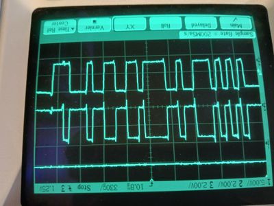

With a scope I see the pull down and then the setup packets going through every address from the host but no response from the STM32.

You can decode the packet if you like, but I've tried on multiple machines so I doubt this is a USB driver issue. None of the packets are longer than this so I assume they're all setup packets.

I've also tried another board without an oscillator installed. In this case the pull-down does not occur, so it is not the case that it's just not detecting the oscillator. The MCU is certainly reaching the USB configuration step but then it is just not responding to USB setup packets.
For the sake of completeness I also installed the oscillator on that board, in which case it behaves just like the first one.
