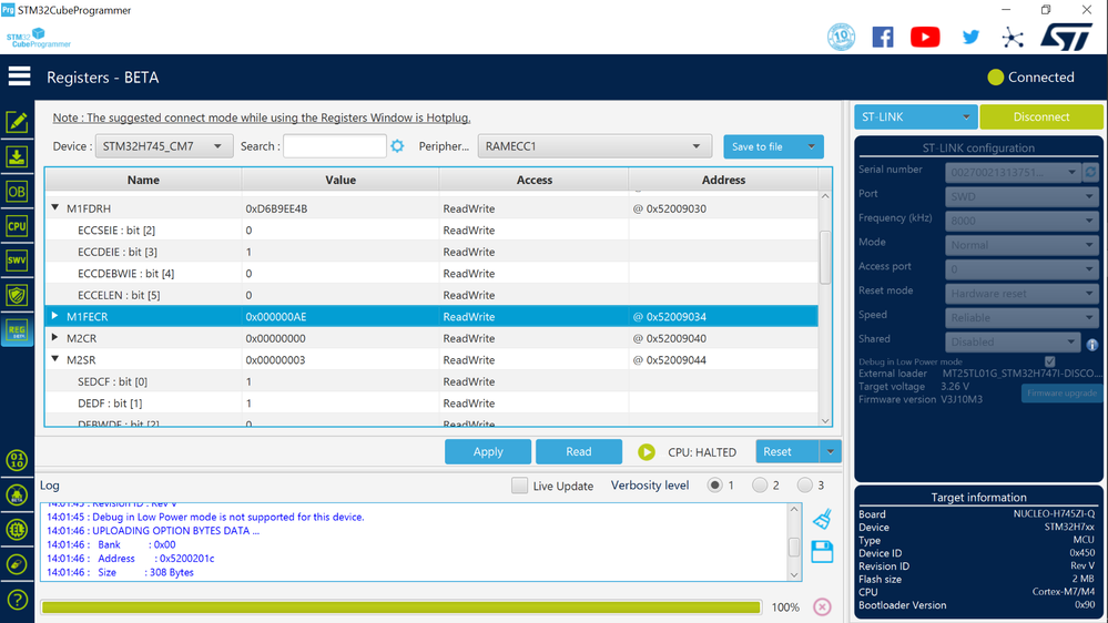

First, RAM ECC cannot be turned off. You can get started with this example. \STM32Cube\Repository\STM32Cube_FW_H7_V1.11.0\Projects\NUCLEO-H745ZI-Q\Examples\RAMECC\RAMECC_ErrorCount
_legacyfs_online_stmicro_images_0693W00000bi6p1QAA.pngFor further details about event monitoring are described in RM0433 Section 3.4: RAMECC_MxSR register. This example can be ported to your STM32H7 MCU.
