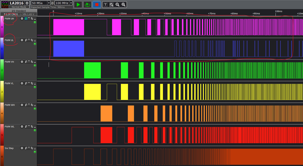

I want to control BLDC motor in six step method using STM32G474RE (nucleo board).
I'm using TIM1 CHx/CHxN complementary PWM output for 6 pwm signal, like below:

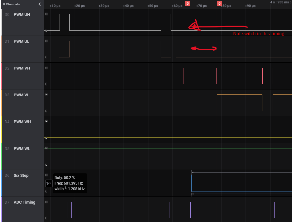

 0693W000008zFe0QAE.pngThe problem I have is that the PWM output does not switch synchronously when switching steps, like below:

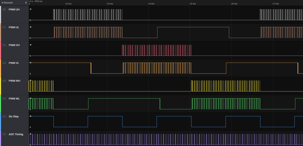

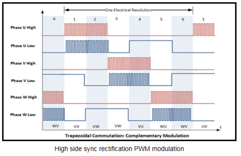

0693W000008zFePQAU.pngThe desired switch looks like this:
0693W000008zFhdQAE.pngHow can I synchronaize the PWM when switching the steps, with STM32G474 MPU?
Please give me some advice.

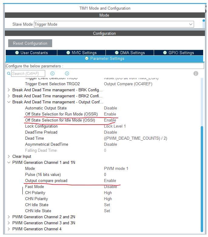

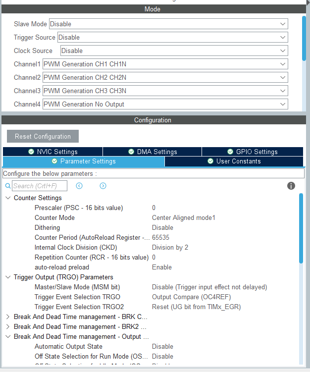

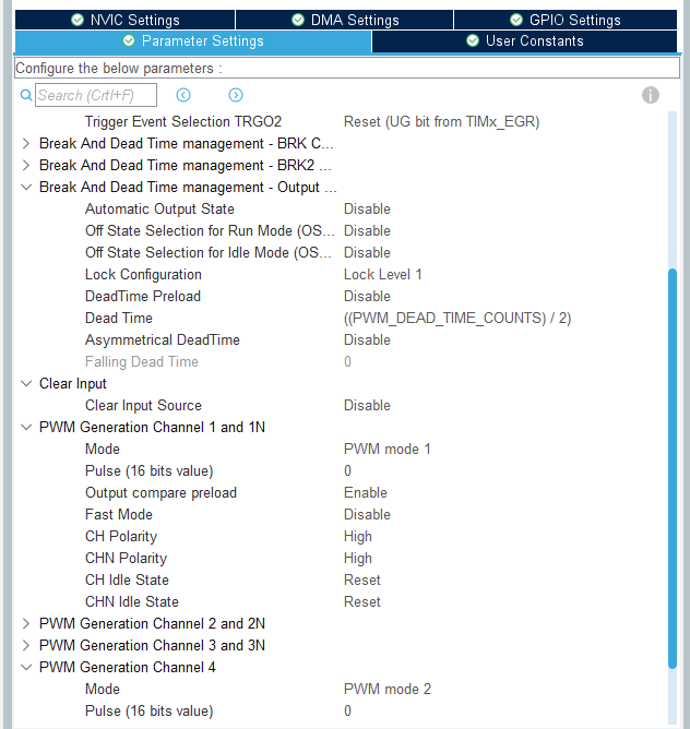

My setting for TIM1 PWM:
 0693W000008zFtqQAE.png0693W000008zG5VQAU.pngAnd, a part of code for six step:

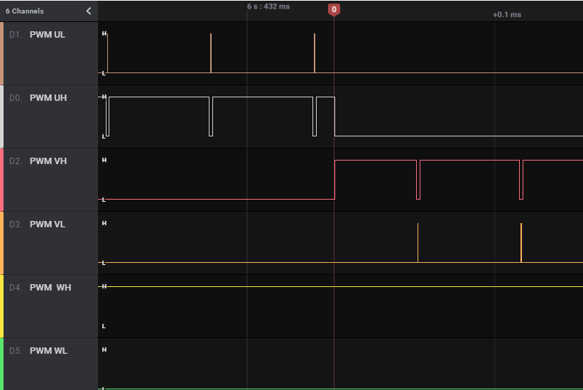

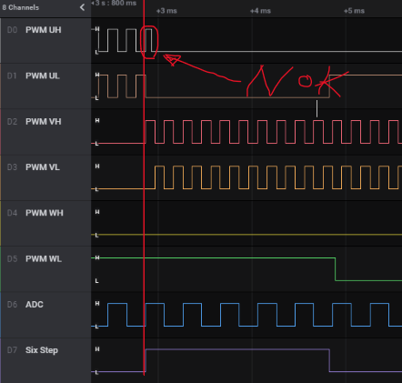

#.1 The way to set low both PWM-UL and PWM-UH is to write code like this:
    htim1.Instance->CCER &= (uint16_t) ~TIM_CCER_CC1E;
    htim1.Instance->CCER &= (uint16_t) ~TIM_CCER_CC1NE;
​But this code not not switch properly like below:
0693W000008zvUWQAY.png#2. To switch properly, I can use this code.
      TIM1->CCMR1 &= TIM_CCMR1_OC2M;
      TIM1->CCMR1 |= TIM_OCMODE_FORCED_INACTIVE;
But when use this code, the PWM output cannot be restarted as shown in the figure.

I use for PWM-UH/HL
for off:
      TIM1->CCMR1 |= TIM_OCMODE_INACTIVE;
for on:
      TIM1->CCMR1 |= TIM_OCMODE_ACTIVE;
and the result is as bellow. It works correctly only in the two steps of starting the drive.
