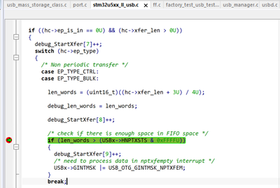

My code hits below statement in the code, here "hc->xfer_len" is 512 bytes and this makes len_words = 128.
The highlighted if statement gets true and due to that NPTXFEM, interrupt is getting enabled.
As soon as the interrupt is enabled we are continuesly getting NPTXFEM interrupt and code gets hang in HAL_HCD_IRQHandler(),
In stm32u5xx_hal_hcd.c file this interrupt is not handled.
Could some one please help me in understanding how to handle this interrupt? and what should be the ideal size for bulk endpoints?

The snippet that you're quoting is here in function USB_HC_StartXfer() , correct?
Is it called in context when the USB interrupts are enabled ?

1. Yes, correct the snippet is from USB_HC_StartXfer().
2. Yes interrupts are enabled while calling that function.
Try to disable interrupts (at least the USB interrupt) around calling USB_HC_StartXfer.

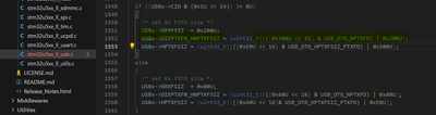

But my query was related to NPTXFEM interrupt which is getting enabled whenever we are trying to write data more than the space available in non-periodic transmit FIFO, and it generates NPTXFE interrupt which is currently not handled in stm32 HAL library (HAL_HCD_IRQHandler).
Also As per data sheet of STM32U575 max size for DIEPTXF0_HNPTXFSIZ (Non periodic transmit FIFO) is 512 bytes, but HAL library allocates only for 128 bytes in USB_HostInit().
Could you please let me know how to handle that interrupt?
Is the USB working in full speed or high speed mode? If FS, there's no way to send a 512 byte packet.
The software can send more than the endpoint size (which is limited by the mode, either FS or HS ), then the interrupt handler should automatically forward the used data pointer and send the next portion. If this does not work, please report a bug.
