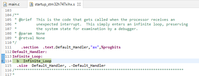

Hi TDK,
Yes, I did that. The TIM8_UP_TIM13_IRQn was my first pick (before I asked you):
// Set the TIM8 priority
HAL_NVIC_SetPriority(TIM8_UP_TIM13_IRQn, 0, 1);
/* TDK: Enable the TIM Update interrupt */
__HAL_TIM_ENABLE_IT(&htim8, TIM_IT_UPDATE);
// Enable the TIM4 global Interrupt
HAL_NVIC_EnableIRQ(TIM8_UP_TIM13_IRQn);
The callback never hit:
void HAL_TIM_PeriodElapsedCallback(TIM_HandleTypeDef *htim)
	// Other timers can use this callback
	if (htim->Instance == TIM8)
		encoderPulsesOvf++;
Even it falls into a infinitive loop:
0693W00000D10lLQAR.pngIf I comment out "__HAL_TIM_ENABLE_IT(&htim8, TIM_IT_UPDATE)" then there is no inf. loop, but the callback is never hit.
I guess because the used the TIMER8 update IRQ, we do not need to enable it again. This seems to me logical, but why not the callback is not hit?
Any idea?
Thanks,
Louis
It's in an interrupt handler that you didn't define so it defaults to Default_Handler.
Ensure TIM8_UP_TIM13_IRQHandler is defined appropriately.
