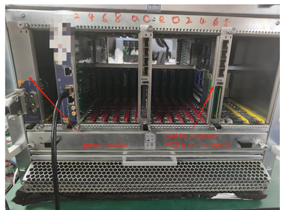

No , it is a independent power module for uTCA system, product weblink: https://nateurope.com/product/nat-pm-dc48/
There is big chassis to hold power module and customized cards. We used STM32F103VET6 as microcontroller on customized cards. While the power module is responsible to do power management and monitoring for all cards.

the last question you asked, I also want to know, but now only the original equipment manufacturer could answer this. I used some commercial system chassis and system as shown below:

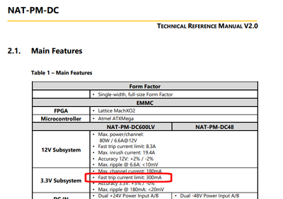

@JKW wrote:independent power module for uTCA system, product weblink: https://nateurope.com/product/nat-pm-dc48/
The Technical Reference Manual suggests that it shouldn't trip until 300mA:
So even less likely that's down to the microcontroller starting up!

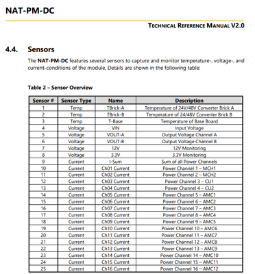

The TRM also says there's a load of current sensors built in:
Could they help you?

Yes, it has current sensor built in power module, but it didn't say how I can read the current value it measured.
