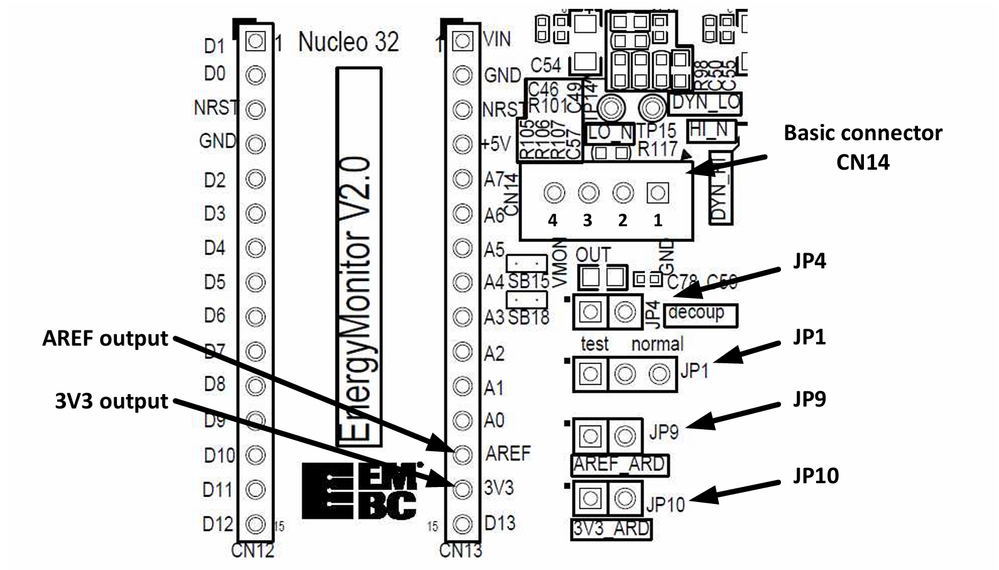

  • Power output is taken from CN14 (OUT and GND pins) on the LPM01A.
  • These lines are directly connected to the Arduino UNO's 3.3V pin and GND.
  • The LPM01A is powered via USB and in normal measurement mode.

It should work fine. What pins are you using? Should be using pins 1 and 3 of CN14. Perhaps show a picture of your setup.
Uday
Uday
Thank you for the response.
Yes, as specified in the user manual, I’m using pin 1 (GND) and pin 3 (VOUT) of CN14 on the X-NUCLEO-LPM01A board.

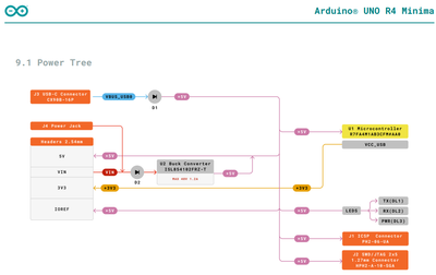

R3 Schematic: https://content.arduino.cc/assets/UNO-TH_Rev3e_sch.pdf
R4 Schematic: https://docs.arduino.cc/resources/schematics/ABX00080-schematics.pdf

If you just apply power to the 3V3 pin, you are just driving the output of the LDO - so there is no power to the MCU or the rest of the system!
PS:
Similarly for the R4:
https://docs.arduino.cc/resources/datasheets/ABX00080-datasheet.pdf#page=12
