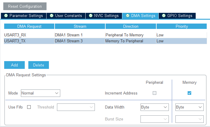

I suggest to use USART with DMA and idle line detection.
below is an example
uint8_t  RxBuffer[256],RxLenght;
// in init
HAL_UART_Receive_DMA(&huart3,RxBuffer,255);
__HAL_UART_ENABLE_IT(&huart3, UART_IT_IDLE);
in it file
void USART3_IRQHandler(void)
  /* USER CODE BEGIN USART3_IRQn 0 */
	if(__HAL_UART_GET_FLAG(&huart3,UART_FLAG_IDLE))
		HAL_UART_DMAStop(&huart3);
		//Calculate the length of the received data
		RxLenght= 255 - __HAL_DMA_GET_COUNTER(&hdma_usart3_rx);
		//Restart to start DMA transmission of 255 bytes of data at a time
		HAL_UART_Receive_DMA(&huart3, (uint8_t*)RxBuffer, 255);
  /* USER CODE END USART3_IRQn 0 */
  HAL_UART_IRQHandler(&huart3);
  /* USER CODE BEGIN USART3_IRQn 1 */
  /* USER CODE END USART3_IRQn 1 */

Hi @Muhammed G�ler​ !
Thanks for the screenshot and code, seems pretty simply and efficient. I'll give it a try and let you know about it.

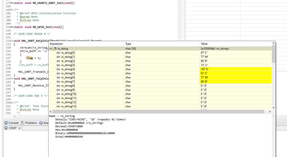

Hi again!
I'm trying to detect the '\r' character at the end of the sent string, but when sending a string via the STM32CubeIDE built-in serial monitor in debugging mode, I get a strange behavior. See in the screenshot below, sometimes there is the '\r' at the end of the string (when I first sent "CMD" and hit Enter), sometimes not (then I sent "kCMD").
0693W00000NpkdhQAB.pngHow could I manage to get the '\r' every time when I send a string?
Loïc
