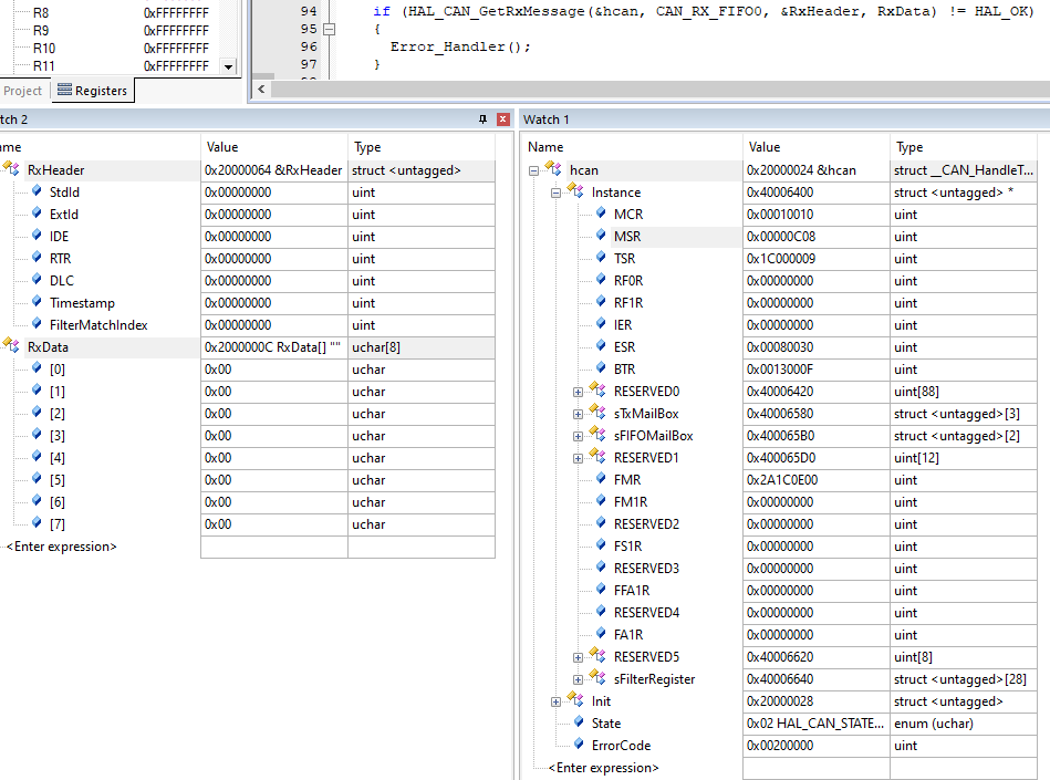

Any help? I am reading can and getting all zeros when connected to car CAN bus. Why could I get zeroes?0690X00000Buc42QAB.png

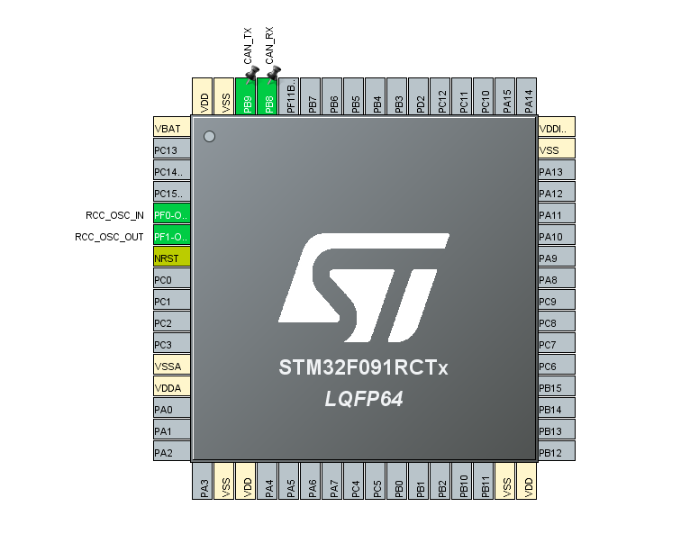

I have connected transreceviver to PB8 and PB9.

JBond.1
Senior II
#define HAL_CAN_ERROR_PARAM          (0x00200000U) /*!< Parameter error
As I understand I am getting this error. What does this error mean and how to fix it?

JBond.1
Senior II
It started working!
I have calculated correct quantas by this video:
https://www.youtube.com/watch?v=rpE5UvQDcy4&list=PLERTijJOmYrApVZqiI6gtA8hr1_6QS-cs&index=14
