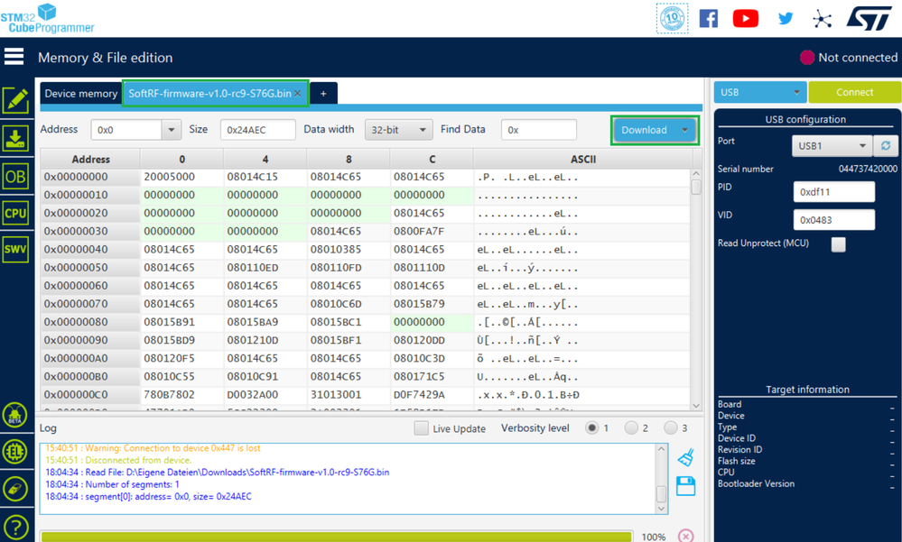

maybe a bold question (since I am new to the topic)
I enable DFU mode on the device (STM32) plug it in USB slot, run STMCubeProgrammer. Then I choose USB and click "connect".
I select the binary files which contain the firmware I would like to flash to my device and click "download"
which is this called "download" when I actually "upload the firmware from my laptop's folder to the USB device?
Plus, is there anything else I should take care of when flushing/ updating the firmware of above mentioned device?
Thanks!!
