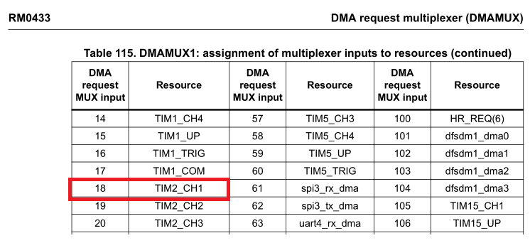

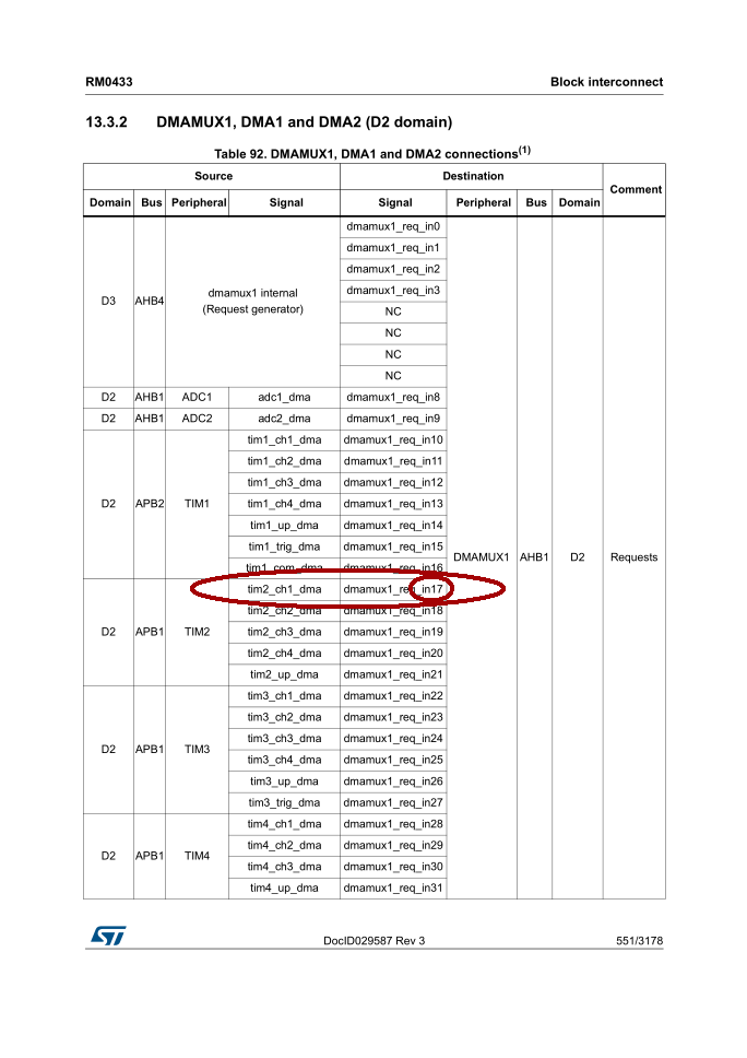

I don't 'H7, but can't this be the problem?
// NOTE: configurate TIM2_CH1 interrupt route
// set DMAMUX to route request (TIM2_CH1)
DMAMUX1_Channel0->CCR |= 18U;
I also am not fan of using magic values; instead, I recommend using the symbols from the CMSIS-mandated device header.

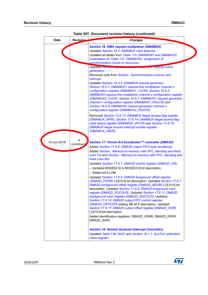

(RM0433 Reference manual STM32H743/753 advanced ARM ® -based 32-bit MCUs) 4th Revision (but it's looks like your document is different from mine, i should look into it too)
I'm totally agree about magic numbers but this is some kind of testing\fluent code I just poke into registers and trying to understand documentation.
The most interesting thing that there are few another question about dmamux configuration (one from stackoverflow, another from local resource) and none of them were answered.
waclawek.jan
Indeed. I have an old copy of the RM.
I don't know then.
