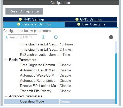

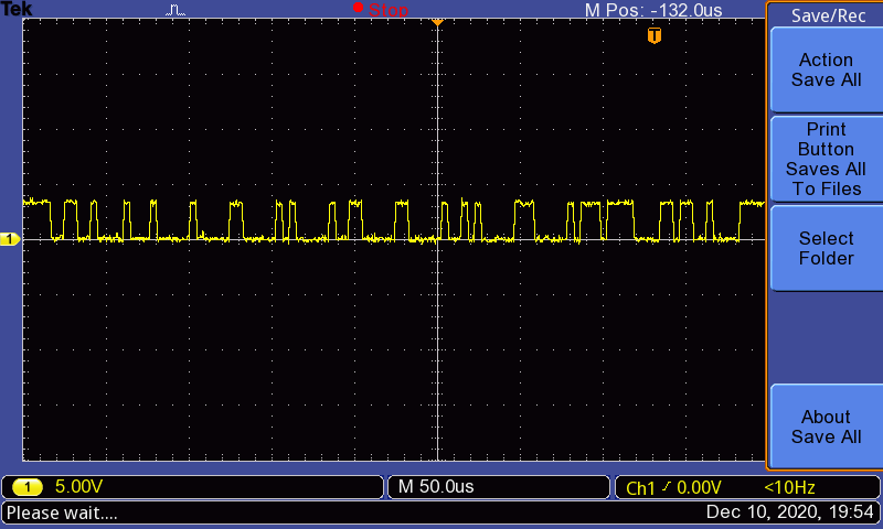

I can able to do "Loopback Mode" and I'm getting the desired output signal(CAN_TX). When I opted "Normal Mode" I can not see any output signal at TX pin.
Here I have selected polling method only and not used any of the interrupt(eg:CAN1_RX0,TX Interrupt). My "BIT Timing Parameters" and LoopBack Output are as shown in the image.
For the better understanding I am adding my code along with this post.
What may be reason? Can anyone please help me?

To be able to use the CAN module in normal mode you have to use a CAN transceiver + termination resistors and connect this node to another node via CAN bus to transceive CAN messages. Please check STM32L476G-EVAL for HW reference.
NUCLEO boards as they are CAN module can be used only in Loopback mode.
