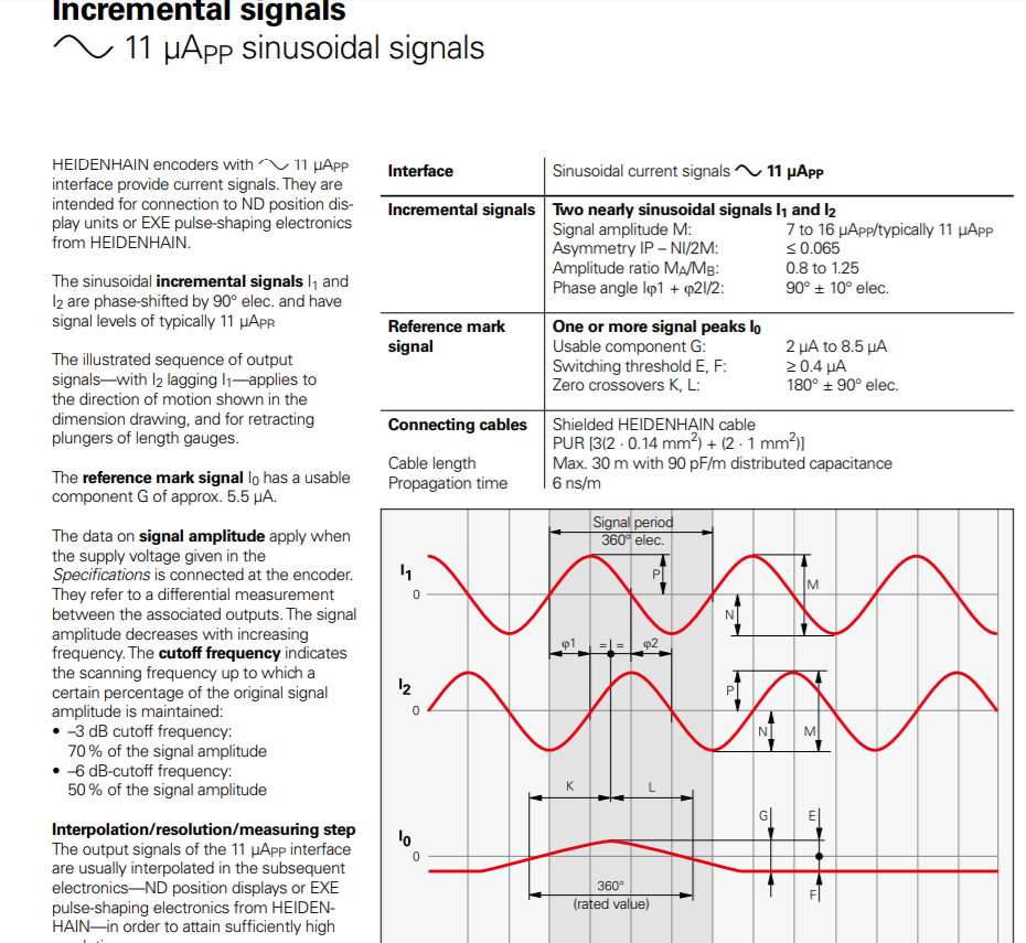

Hi everyone,
With my STM32F103C8T6 I would like to receive the 2 signals I1 and I2 from the picture below in order to convert to
https://community.st.com/tags#/?tags=square%20signal
All the square part is already coded and working great.
Now I would like to learn how to use this
https://community.st.com/tags#/?tags=sine%20waveform
and
signal and interpolate them such as the file attached in order to have a decent precision. For example, in my case the step of the wave is 20 microns so I would like to interpolate it by 20 in order to have 20 pulses of 1 micron.
This is an optical ruler on a milling machine so the ruler can travel in both ways with numerous direction changes
I'm a hobbyist so any bite of code is very welcomed
Right now, I only use Std periph lib, not HAL libraries.
Thank you for your help
#square-signal #sine-waveform #cosine

So for e.g. 6m/min feed rate you're looking at 100k pulses / sec, right? And you want to do the interpolation on a µC? I doubt that's possible.
I'd look for a dedicated IC to do that. There are some around that spit out quadrature square signals which you can easily read on a mcu with your timers. -> no software overhead involved.

That picture suggests that what you have is a Resolver:
https://en.wikipedia.org/wiki/Resolver_(electrical)
These are very long-established devices - so I suggest that you do some research & study into prior art; eg,
https://www.google.co.uk/search?q=synchro+resolver
As the Wikipedia article says,
For the position evaluation,
https://www.google.co.uk/search?q=Resolver-to-Digital+Converter
are commonly used. They convert sine and cosine signal to binary signal (10 to 16 bit wide) that can more easily be used by the controller.

I followed advices above and bought an specific IC: IC-NV
